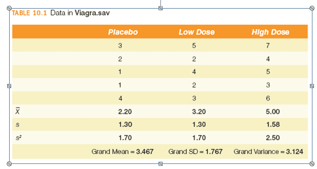

All I did to get the Grand mean was calculate the mean, of the mean's of each group...
I keep getting wrong answer. I don't know what I am doing wrong. :(
Here is the data:

Since the groups all happen to be the same size, that should be fine (but I hope you would not have done that otherwise). And you get 3.467, right?
But you can't do that with the variances because the formula used there has an n/(n-1) term, where n is the number of data values. So for each group that gives 5/4, but for the grand variance it will be 15/14.
Have you tried to calculate the group variances yourself? Do you get the values in the table?

The grand variance is
$$\text{Grand Variance} = {SST \over N-1}$$
where:
##SST## is the sum of the squared differences of each score with the grand mean,
##N## is the total number of scores (15 in your case).​
If you want, you can also calculate it without using the actual scores.
But then you'll need a couple of additional formulas, so you can calculate SST differently.
Do you have formulas for that?

I don't quite understand the SST part of that equation.
Do I take the squared differences of ALL 15 data points, then add them up?
then divide by n-1 ? (14) ?
Yes.
I like Serena said:
Yes.
ahhg I did that! Don't tell me I just messed up on my calculator and that's why I am trying all these different things! lol :)
So are you good now?
Oh yes, I got it! Thanks!
While you are here, your formula make more sense than the one I was given. What is the formula for the Grand SD?
I just square root the Grand Variance correct?
Correct.
If you're interested, here are a couple of other identities (##n=5##).
They come from (one-way) ANOVA theory which is what you are doing.
$$SST = SSM + SSE$$
$$SSM=n((\bar X_1 - \text{Grand Mean})^2 + (\bar X_2 - \text{Grand Mean})^2 + (\bar X_3 - \text{Grand Mean})^2)$$
$$SSE=(n-1)(s_1^2 + s_2^2 + s_3^2)$$
