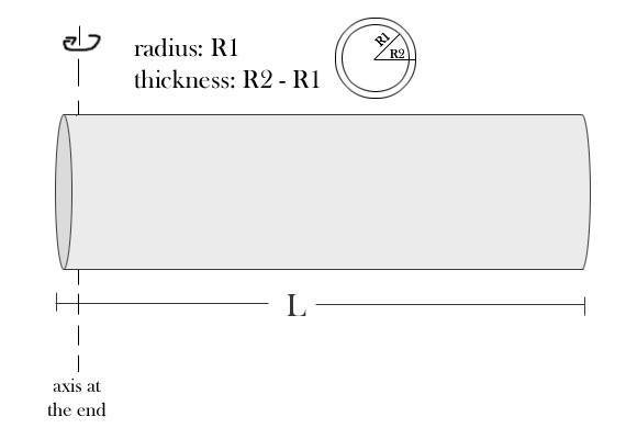

I couldn't find the Moment of inertia of the next tube:
hope you can help..thnks
The moment of inertia for a tube can be calculated using the formula I = (1/4)M(R1^2 - R2^2) + (1/3)ML^2, where M is mass, R1 and R2 are the outer and inner radii, and L is the length of the tube. Users discussed various methods to derive this formula, emphasizing the importance of integration and understanding the physical principles behind moment of inertia. Additional resources such as Wikipedia and HyperPhysics were recommended for further learning.
