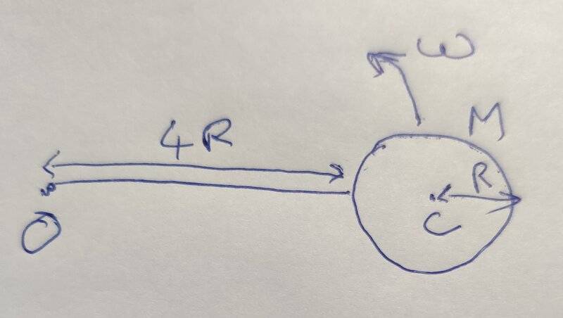

A disk of radius R and mass M is connected to a rod that is rotating about O. The rod is rotating about at an angular velocity of ##\omega## about O. What would be the moment of inertia of the rod+disk system about an axis through O and perpendicular to plane of rotation of the rod. Assume the rod is massless and the disk is not rotating about it's center of mass axis.
##I=\frac {MR^2} {2}## for a disk about an axis through its cm and perpendicular to the disk
## I_o = I_{cm} + M R^2##
I have come up with two different approaches, but I'm not sure which one is correct since they give different answers.
We use the following equation to get the total moment of inertia.
##I_o## = moment of inertia of disk about O axis + moment of inertia of road about O axis
Approach 1:
Consider the disk as a particle at it's center of mass.
##I_o = M (5R)^2 + 0= 25 MR^2##
Approach 2:
We use parallel axis theorem to get moment of inertia of disk about O axis.
##I_o= \frac {MR^2} {2} + M (5R)^2 + 0 \\= \frac {51MR^2} {2}##

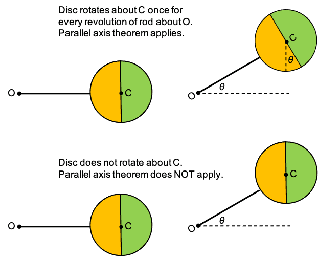

But I note this in post #1: "the disk is not rotating about its center of mass axis."
Technically, that means it retains the same orientation even though its centre rotates about O. I.e. if the rod is rotating at ##\omega## then the disc is rotating at the same rate in the opposite direction relative to the rod. In that case you can treat it as a point particle.
But maybe it means that it is attached rigidly to the rod and so rotates about its own centre at the same rate that it rotates about O. In that case you need to apply the parallel axis theorem.

How does your diagram fits the description "centered at O"? Is this the original text or/and figure?
Thanks for pointing out the mistake. I have corrected it so it doesn't say that. This is a made up problem by me in which I am trying to understand the right way to find moment of inertia of a system.
haruspex said:
Technically, that means it retains the same orientation even though its centre rotates about O. I.e. if the rod is rotating at ω then the disc is rotating at the same rate in the opposite direction relative to the rod. In that case you can treat it as a point particle.
This disk is not rotating about its center of mass axis. It simply moves in a circular orbit and is connected to rod rigidly. Its like a stone tied to the end of a string and the stone is moving in a circular path.
vcsharp2003 said:
Yes, it retains its orientation.
You cannot have it both ways. If it retains its orientation as the rod rotates then it must be mounted on an axle, not rigidly attached.
Ok, I get that. But, why the parallel axis theorem would not be applicable in this problem? I thought it always applies for two parallel axes provided one of the axes is passing through the center of mass of disk.
Yes, but it only applies if the object is rotating as a body about that parallel axis.
More generally, suppose the mass centre of the body rotates at radius r at rate ##\omega_b## about some point, but the orientation of the body rotates at rate ##\omega_c## about the body's mass centre. Then the angular momentum is ##mr^2\omega_r+I_c\omega_c##. The parallel axis theorem is just the special case where the rotation rates are the same.
