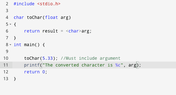

Yes I'm trying to show my code so far but I am still having issues even with copying and pasting as text and using the code tags. Still get this error message: "Oops! We ran into some problems. Please try again later. More error details may be in the browser console." I am hoping that the image works.
One problem is that you are trying to use char as a function: instead you should write char result = <char>arg;. Another problem is that you are redefining arg as a variable when it is already defined as a parameter: delete the line float arg;.
1. Change the name of the function -- toFloat() suggests that it's going to convert something to a float. That's not what the function should be doing.
2. Delete the first two lines of the function body.
3. Change the third line so that it returns the function's argument.
Like I said, all you need is a single line of code in the function body.

Mark44 said:
But did you get something to work yet?
Not quite, I am still trying with everyone's suggestions.
This won't compile (syntax errors):
  1. result in your function is not declared.
  2. arg in main is not declared.
You also have a semantic error (a type of error that isn't due to improper use of the language, but nevertheless causes problems).
Your toChar() function is defined to return a char value, but you aren't using it. For any function that returns a non-void value, the call to the function should most often be on the right side of an assignment statement or as a value to be displayed via printf or anywhere else where a value is meant. Such a function should not be called like you have done; i.e., as toChar(5.33); .
If the syntax errors are fixed, when you compile and run the code, the function will calculate its value correctly, but the call to this function shown above will cause the value to be discarded.
