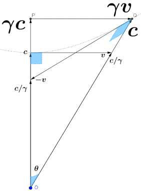

How, therefore, should a spacetime diagram showing the three vectors,: velocity through space, velocity through spacetime, and velocity through time be drawn and what equation would describe it?

runningc said:
How, therefore, should a spacetime diagram showing the three vectors,: velocity through space, velocity through spacetime, and velocity through time be drawn?
Velocity through spacetime is a somewhat sloppy notation for the four-velocity. Once you choose that and pick a frame, any meaning of "velocity through space" and "velocity through time" is completely constrained. Usually you'd interpret "velocity through space" as the spacelike components of the four vector (give or take a factor of gamma) and "velocity through time" as the timelike component (I have seen more complicated interpretations).
So what that means is that you draw a Minkowski diagram. The four-velocity is tangent to the object's worldline, and its spatial and timelike components give you everything else you asked for.
You wouldn't show three vectors, you would show one four-vector. You would draw it at less than a 45 degree angle from the time axis and with the arrow pointing towards the future.

robphy said:
Here's a spacetime diagram
In trigonometric form,
[itex]v/c\quad\ =\tanh\theta=\frac{opp}{adj}[/itex]
[itex]\gamma\qquad \ =\cosh\theta =\frac{adj}{hyp}[/itex]
[itex]\gamma(v/c)=\sinh\theta =\frac{opp}{hyp}[/itex]
(I updated the diagram by indicating the rapidity [itex]\theta[/itex] (the Minkowski-analogue of the angle).
By the way, the rapidity of the Minkowski-right-angle is infinity.
I also added the interpretation of "tangent" as "opposite over adjacent", etc...
Also note: the tangent-line to the Minkowski-circle is Minkowski-perpendicular to the radius.)
