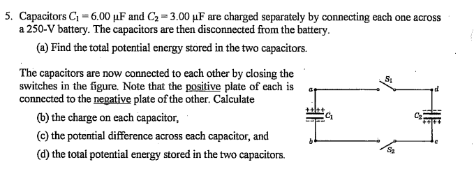

How Do You Solve Capacitor Equilibrium Problems?

Circuit schematic with two capacitors, C1 and C2, and switches S1 and S2 arranged in a loop; the textbook problem statement lies beside it.

I'm just stuck on b. I tried doing Qeq= √(2UC) then using the fact that q1+q2 = Q which is Qeq since charge should be conserved. Then from the fact that at equilibrium the potentials should be equal, q1[itex]/[/itex]c1 =q2[itex]/[/itex]c2
so
q2 + q2c1[itex]/[/itex]c2 = Qeq
But that didn't work.
Apparently the answer is A) 281mJ B) Q1' = 500[itex]\mu[/itex]C Q2' = 250[itex]\mu[/itex]C C) V1' = V2' = 83.3V D) U' = 31.3mJ
Thing is - some of the charge is negative and some positive.

Circuit diagram with capacitors C1 (6.00 µF) and C2 (3.00 µF) and switches S1 and S2 arranged in a loop, with the problem text for parts (a) through (d) printed above.
  • Circuit diagram with capacitors C1 (6.00 μF) and C2 (3.00 μF), switches S1 and S2, and a printed problem statement about charging the capacitors across a 250-V battery and connecting them plate to plate.

The first thing is to determine Q1 and Q2 , the charge on each capacitor prior to the switches being closed.

Initially you have 1500 μC on C1 and 750 μC on C2. The capacitors are connected, positive plate to the negative one. The charge can migrate between the connected plates, and 1500 μC - 750 μC = 750 μC - that is the charge of the resultant equivalent capacitor; and Ceq=9μF.
From these data you get the voltage, which is equal to the common voltage across the individual capacitors. You get the new charges on both capacitors from the common voltage and the capacitance. ehild

OOOOOOOH. Because they are connected from positive to negative, the resultant net charge is no longer 750+1500 it's 1500-750 because the charge migrates. But why is it 1500-750 and not 750-1500? Could have just as easily been negative no? Is it just because we had a positive voltage that we know the charge is positive?

Two plates are connected. Charge can migrate to one to the other, but nowhere else. The sum of the charges on C1 and C2 must be constant. Q1=1500 μC, Q2=-750 μC, so the whole charge on the connected upper plates is Q=750 μC. At the same time, there is -1500 + 750 = -750 μC charge on the bottom plates.
That charge is shared between the capacitors, the charge of C1 becomes q1 and the charge of C2 becomes q2, positive on the upper plates and negative, -q1 and -q2 on the bottom plates. You have found the common voltage already: U=Q/Ceq=(750/9 )= 83.33 V.
Using q=UC, find the individual charges.

Oh that makes a lot of sense. I sometimes become so dependent on the equations and specific phenomena that I have studied during the course that some of the most intuitive and simple problems suddenly become really complicated to me because they aren't described by a formula or aren't something I've seen before. I had my exam today and I did really well. Thanks for all your help, I appreciate it. I hope I can help others on here as you have helped me :)
