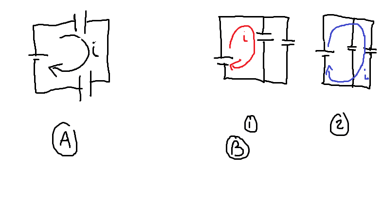

C1 is not in parallel with C5 .
How is it not parallel with C5? I understand parallel to be this and that's what I see...
So the total capacitance would be (1/C1234+1/C5)^-1 ?
If those capacitors were resistors, would you say they're in series or say they're in parallel ? (in either figure)
Think of parallel and series in this way.
To be in series, there is only one way for the current to get from start to finish, and that's through the circuit elements you're interested in. (A)
However, when two things are in parallel the current can either go through one, or the other, and still end up completing the circuit (B)
See my drawing
Apply this to your circuit, what conclusion do you have to make when it comes to the current passing through C1 and C5

Oh I see... so a parallel series is when the current is split and can go through one of multiple paths. That helps a lot. I wish I had tried that possibility before resorting to the forum for help. Thanks.
