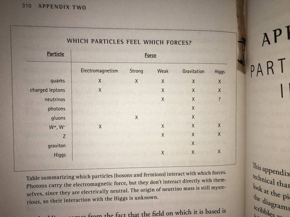

A table from Sean Carroll's 'The Particle at the End of the Universe' says that photons don't feel electromagnetism. I'm wondering how this is so.
I've attached a picture of a table in Sean Carroll's The Particle at the End of the Universe. It says that photons don't "feel" electromagnetism, but gluons feel the strong force, the W and Z bosons feel the weak force, and gravitons feel gravitation. How is this so?
(I have no formal quantum physics training, just a fair amount of classical as a mechanical engineering PhD)

Photons have no charge.

Alright, that's what 'feel' means. That makes sense. I can't really make sense of how these bosons are vibrations in their respective fields but some are and some aren't affected by the forces arising from that field. Do you recommend any particular introduction to quantum mechanics textbook that might give me a deep enough understanding to get rid of my confusion here?

This was covered in my second year of graduate school. You are three or so textbooks behind. If I told you "it's because electromagnetism is a U(1) and QCD is an SU(3)" it would be true, but that assumes years of background.

Photons don't feel the EM force because photons themselves have no charge and QED is relatively simple. Gluons, on the other hand, have color and QCD becomes monumentally complicated.
That ultimately stems from the dimension of the symmetry that nature chose in each case: a simple ##U(1)## symmetry for QED and an ##SU(3)## symmetry for QCD.

A slightly more informative answer than the one @Vanadium 50 gave is that U(1), the gauge group of electromagnetism, is an abelian group--any two elements of the group commute--while SU(2) (weak force) and SU(3) (strong force) are non-abelian--not all group elements commute. And it turns out that if the gauge group is abelian, the force carriers don't carry any charge, but if the gauge group is non-abelian, they do.

@Marshall2389, direct a laser beam through a region of space where a magnetic and/or an electric field is present. Since classical electrodynamics is a linear theory, the laser beam will be unaffected by the magnetic (electric) field. You can even try to "collide" two laser beams and they will pass through each other completely unaffected. In that sense photons don't feel each other, aka, they don't feel electromagnetism.=================================
As a twist of the story, photon DO feel other photons and electromagnetic fields in general. They do it indirectly since they don't have change, but the interaction is there and it might be relevant. The process is called photon-photon scattering

Photons ARE the force carrier for electromagnetism. They do not interact with each other (well except in very exceptional situations way out of the scope of the discussion here). They only interact with other charged particles.

So the only B-level explanation of this question is: Photons are quanta of electromagnetic energy and they ##\bf{do}## feel electromagnetism (i.e. they ##\bf{do}## feel other photons) at sufficient high energies (Delbrück scattering).
