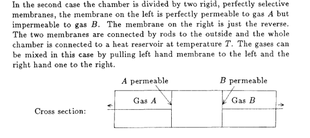

In the second case the chamber is divided by two rigid, perfectly selective
membranes, the membrane on the left is perfectly permeable to gas A but
impermeable to gas B. The membrane on the right is just the reverse.
The two membranes are connected by rods to the outside and the whole
chamber is connected to a heat reservoir at temperature T. The gases can
be mixed in this case by pulling left hand membrane to the left and the
right hand one to the right.
All below
Diagram of a cross section of a chamber divided by two rigid membranes: the left one labelled A permeable with Gas A on its left side, the right one labelled B permeable with Gas B on its right side, with arrows showing the membranes pulled outward.
Diagram of two chambers side by side: Gas A with n_A moles and volume V_A on the left, and Gas B with n_B moles and volume V_B on the right.
We need to find the system's entropy variation.
I don't think i understood pretty well what is happening in this process, can someone help me how to start?

You might approach this by calculating the work done (assume a quasi-static equilibrium, i.e., if the membranes are moved, they are moved slowly). There will pressure differences on the membranes, and thus forces on the membranes, and you can calculate the work by applying [itex]W = \int \vec F \cdot \vec {dx}[/itex] (work is equal to force times distance).
Keep in mind the chamber is connected to a heat reservoir, keeping everything at a constant temperature. If I'm not missing something, this makes the problem easier (I think).

You need to find the entropy variation as a function of what?
Just as a function of the moles, the volume and the pression, that is, the variables in the box i posted above.
WIth the help above, i tried to find the change in entropy exactly as would be if the gases were expanding freely.
Anyway, the problem i think became easier because the constant temperature, i found:
R(na*log(Va+Vb)/Va + nb*log(Va+Vb)/Vb)
Actually, the most problematic thing here to me was to see that the membrane in its initial state had no width significance (the problem said nothing about it, so it was tricky hard to understand) , so we could say that V total = Va + Vb, on the other case we would not use the formula above

This problem was meant to be solved by designing a reversible process between the initial and final thermodynamic equilibrium states of the system, and determining the work done and the heat transferred. If you want, I can lead you through exactly how to do this.

OK. If the membrane that is permeable to A is situated between a volume of pure A and a mixture of A and B, what is the condition for the equilibrium of A across the membrane?

Maybe the forces (so pressure) need to be equal.
Par = Pmixing
nar/Vaf = (na'+nb')/Vmix
nar = na + na'
where nar is the a's mol remanent
na' is the mol inside membrane
Vaf is the volume of A in the instant

What I was looking for was that, for equilibrium of A across the semi-permeable membrane, the partial pressure of A in the mixture ##p_A## has to be equal to the total pressure of pure A in the volume of pure A, ##P_A##:
$$p_A=P_A$$
Were you aware of this equilibrium condition for an ideal semi-permeable membrane for an ideal gas?

Actually i think i didn't know about this yet, can you say more about it or recommend some reading about?
Knowing this is key to solving this problem. There is no fundamental reference for this. It is just the definition of an ideal semi-permeable membrane.
Are you ready to continue with the rest of the analysis?
