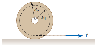

A spool of thread consists of a cylinder of radius R1 = 6.6 cm with end caps of radius R2 = 9.3 cm as depicted in the end view shown in the figure below. The mass of the spool, including the thread, is m = 290 g. The spool is placed on a rough, horizontal surface so that it rolls without slipping when a force
= 0.690 N acting to the right is applied to the free end of the thread. For the moment of inertia treat the spool as being a solid cylinder of radius R1, as the extended edges are thin and therefore light.
(a) What is the acceleration of the spool? Take positive to be to the right.

I need some help with this problem. I don't think my attempt is even correct. But my thought is since T = I*A. Then I just need to solve for A. A = T*I. The moment of inertia is what is stumping me. I'm not sure if I'm doing this correctly. I = 1/2(.3)(.066) = 0.0099. This does not solve the problem adequately. Thanks of the help!
*Where T is force
A is angular acceleration
I is moment of inertia.

What are A and a? T is the force in the problem. Better to denote it F.

The horizontal surface applies a force to the left at the edges of the end caps as the spool accelerates. This torque is partially opposed by the thread's force to the right at the edge of the inner part of the spool.

The torque is defined with respect a point or axis. What is your point of reference?

Yes, but how is the torque of a force defined?

Well, how much is the torque of the applied force in this case?

The torque is not force.

I leave you now, I have to sleep. Read your notes or handbook or the page you cited about the torque. You might remember that you get it multiplying the force with its lever arm.

I'm considering the axis of the spool as the center of rotation for the net torque. If viewing this as an instant in time, then the point of contact with the surface could also be used, in which case the ground force doesn't matter, so the only torque is related to the tension in the string times the distance above the surface, but the moment of inertia about the point of contact becomes more complicated. The problem statement defines the moment of inertia about the axis of the spool, which is why I chose that as the reference point for the torques.
Back to the original question, note that the linear acceleration equals the net linear force divided by mass. The net linear force equals the tension to the right minus the surface force to the left. The angular acceleration equals the linear acceleration divided by the radius of the end caps.

I very strongly encourage you to develop the habit of working as far as possible without numbers. It has many advantages, and you will get better at it with practice.
With regard to the present problem, I consider it simpler to take moments about the point of contact with the ground. You just need to apply the parallel axis theorem, which I assume you have met. But go with rcgldr for now and we can look at that for comparison later. Anyway, I see this is part a) only. Depending on what the other parts ask, there might be no advantage.

Anyway, taking moments about point of contact produces immediately ##\alpha=\frac{T(r_2-r_1)}{m(\frac 12r_1^2+r_2^2)}##

I ended up with
f = t (r1 r2 + (1/2 r1^2)) / (1/2 r1^2 + r2^2)
linear acceleration = (t - f) / m = (t r2 ( r2 - r1)) / (m (1/2 r1^2 + r2^2))
angular acceleration = linear acceleration / r2 = t (r2 - r1) / (m (1/2 r1^2 + r2^2))
As pointed out by haruspex, parallel axis theorem makes this much easier, but I don't know if that was covered in the originator's class yet.
