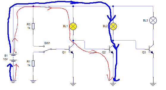

BUT YOU CIRCUIT IS NOT LIKE MINE IN BOOK? in the book they did it with resistor two transistor the third transistor they did with lamp so they work like yours, but to me they work on on off not like in book, but in the book they did tell which value of reisistor i must put in circuit? so i don't know where i make mistake if you can teach me where i make mistake and how work thnk for time
Simply you forget about Q2 base current and also that light bulb has low resistance.
In your diagram Q1 is CUT-OFF completely Q3 is also CUT-OFF completely because Q2 is in saturation.
So he short Q3 base to GND. Or if we use a different point of view.
Q1 is off because Q1 base don't see any close path from Vcc.
But Q2 is "ON" because there is a path for the Q2base current from Vcc through light bulb to Q2 base-emitter and back to GND. And this flow of a Q2 base current will "ON" the Q2 and Ic current will start to flow from
Vcc--->BL2 ---> collector-emitter---->GND
And Q3 is also cut off because Q2 steals all the current from Q3 base current (short Q3 base to gnd).
So as you can see despite the fact that Q1 is OFF. There will be a current flow through the BL1 bulb.
Of course this current is a Q2 base current but still the bulb will light because Q2 base current is determined by BL1 resistance and OHMS law.
Ib2 = (Vcc - Vbe2)/Rbulb.

But as you can see in the diagram You and I have a switch in position B,
And in my post I described how this circuit work when switch is in B position. And I ask you why BL1 light bulb glow when we have a switch in B position. And I don't see any mistake in circuit. And everything work as is should.

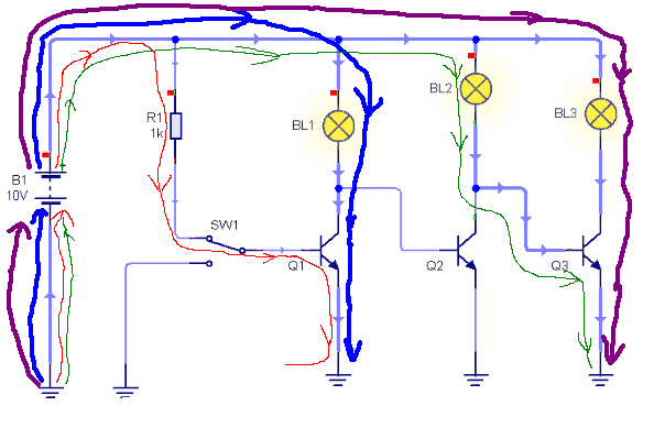

Second if you want to make transitor to work like a switch there is only one way which you give me circuit to add resistor in serie in base?
Ok I will try to explain you how this circuit work.
First we have a switch in A position.
And the situation look like this
We start our analysis at Q1 base. Q1 base see a path for his current from Vcc.
And this is why Q1 will turn ON. I repeat -> Q1 "ON" because there is a path for the Q1 base current from Vcc through R1 --->Q1 base-emitter and back to GND.
I mark Q1 base current in red.
Vcc --- > R1 ---> Q1 base-emitter junction --- > GND.
And this base current Turn ON the transistor. So Collector current can flow in this circuit.
Vcc--->BL1--->Q1 collector-emiter --->GND
Q2 is CUT-OFF because Q1 shorts Q2 base to ground via saturated (Full "ON") Q1.
Q3 base also see a path from Vcc via BL2. So Q3 base current start to flow in this circuit:
Vcc --->BL2--->Q3 base-emitter junction--->GND
This current will TURN ON Q3 so collector current will start to flow:
Vcc--->BL3 ---> Q3 collector-emitter--->GND
Now we flip the switch into B position. And the situation look like this:
Q1 is CUT-OFF because Q1 base is short to ground via 1K resistor (Q1 base don't see any close loop path to Vcc ).
But now Q2 will see a path for his current from VCC. And this base current will start to flow in this circuit :
Vcc --->BL1--->Q2 base-emitter junction--->GND
This base current will TURN-ON Q2 so that Q2 collector current will start to flow:
Vcc--->BL2--->Q2 collector - emitter--->GND
Q3 also will be in CUT-OFF because Q2 transistor collector-emitter saturation voltage (Vce(sat)) is lower then 0.6V needed to TURN ON Q3 (Q3 base is shorted to ground via saturated Q2 ).

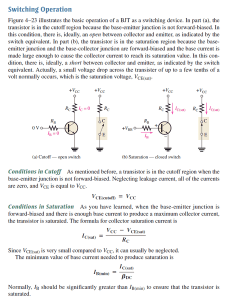

In circuits when transistor work as a switch (transistor is in saturation region of in cut-off) we can easily calculate all current in the circuit. All we need to know is the resistance and Vcc voltage.
The base current is equal to:
Ib = (Vcc - Vbe)/Rb where:
Vcc --> power supply voltage
Vbe --> Base-emitter diode forward voltage drop (0.6V ... 0.8V)
RB --> base resistor resistance in our circuit Rb is 1K for Q1 base and for the rest of a transistors RB = light bulb resistance.
And collector current is equal to
Ic = (Vcc - Vce(sat))/Rc
Vce(sat) - Collector-emitter saturation voltage (0.2V typical).
Rc --> resistance connect between Vcc and collector in our case light bulb resistance.

Once more take a look at this
As you can see we have a switch in A position. So Q1 is ON ; Q2 is OFF and Q3 is ON.
And second bulb glows, because Q3 transistor base current is now flowing through the light bulb. The Q3 base current is mark in green on the diagram.
when i switch to b
first buble glow current is zero, second buble glow there is a current, and third buble is off there is zero current, why the buble one glow? what is voltage and current
Because now despite the fact that Q1 is OFF the BL1 current is not equal to 0A.
As you can see here in red
Q2 transistor base current is now flow through first light bulb.
Additional the light bulb resistance is ""low" so the base current is high:
Ib = (10V - 0.7V)/100Ω ≈ 93mA and this is why light bulb glow (shines).

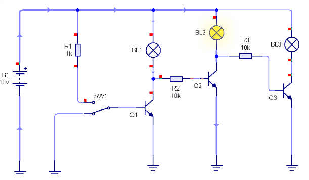

you told me very good how they work but the buble don't work
so johny what do you think ? what is the problem in circuit?
But everything work as is should be. And to fix this issue with the bulbs simple reduce the base current.

Are you sure that current is zero for second bulb (BL2)? You still forgetting about base current.
And second bulb glows, because Q3 transistor base current is now flowing through the light bulb. The Q3 base current is mark in green on the diagram. Because now despite the fact that Q1 is OFF the BL1 current is not equal to 0A.
Ib = (10V - 0.7V)/100Ω ≈ 93mA and this is why light bulb glow (shines). But everything work as is should be. And to fix this issue with the bulbs simple reduce the base current. Can you tell me the name of the book you are reading now?

Ok. If we assume R_bulb = 100Ω . Don't forget that light bulb resistance is also voltage dependent (nonlinear). Light bulb resistance change when you apply different voltage to it.
So for switch in B position Q2 base current will be around
Ib2 = (Vcc - Vbe2)/R_bulb ≈ (10V - 0.7V)/100Ω ≈ 93mA
And Ic2 = (Vcc - Vce(sat)) ≈ (10V - 0.1V)/100Ω ≈ 99mA
That's all we can do, we are forced to assume Vbe and Vce(sat) values, because we don't know nothing about this ideal BJT use in simulator.
