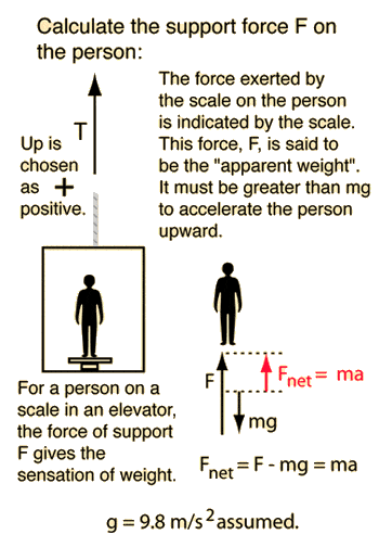

A person standing on a bathroom scale in an elevator notices that when the elevator starts to move their weight decreases to 0.73 of its original reading. What is the acceleration of the elevator?

Diagram of a person on a scale inside an elevator, with an upward tension T and up chosen as positive; a free-body diagram shows support force F up, mg down, and Fnet = F - mg = ma, with g = 9.8 m/s^2 assumed.
If you are accelerating upward you feel heavier, and if you are accelerating downward you feel lighter. If the elevator cable broke, you would feel weightless since both you and the elevator would be accelerating downward at the same rate.
  • Diagram of a person on a scale in an elevator with upward tension T and up taken as positive, plus a free-body diagram with support force F upward, weight mg downward, and Fnet = F - mg = ma; g = 9.8 m/s^2 assumed.

No; the mass is not changed. What changes when the elevator accelerates is the normal force from the bathroom scale. It was equal to mg when the elevator was not moving. What is the normal force now that the elevator is moving?
the normal force is equal to what it was originally multiplied by 0.73?
Yes, that's right; so now with the elevator in motion the normal force is N=0.73 mg.
Now Newton's law says the sum of the forces in some direction equals the mass time the acceleration in that direction. (Here the only direction required is vertical.) Write out Newton's law for these two forces (normal and gravitational) and set it equal to ma. Then solve for a. What do you get?
Be sure to check for the right sign for the force components.

so now i have (0.73 x mg) which is the Normal force, then i have mg as the gravitational force so if i add those together do i get ma? Then if I rrearrange m to the other side does that cancel the other m's? and is that the final answer?

That's right; but remember that the normal force is pushing upwards on the person and you had that as positive (so you are choosing upwards as the positive direction) and the gravitational force is downwards so it will be negative. Adding those positive and negative values together equals ma.
What equation do you get?
Then solve for a. If the number you get for a is positive, the elevator is accelerating upwards; if it is negative it is accelerating downwards.
