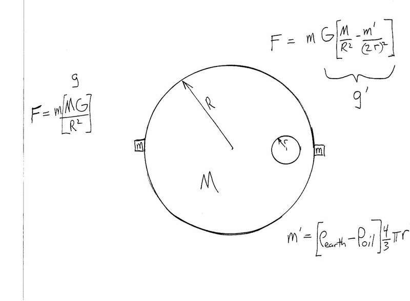

Problem:
The center of a 1.30 km diameter spherical pocket of oil is 1.30 km beneath the Earth's surface.
Estimate by what percentage g directly above the pocket of oil would differ from the expected value of g for a uniform Earth? Assume the density of oil is 8.10x10^3 kg/m^3
Should I use the equation: F = G (m1 + m2) / r^2 ?
If not, which equation should I use?
Please help me to get started.
Thank you.
Does this seem right way to find g and g'?
  • Handwritten diagram of a large circle labelled M with radius R, a small inner circle of radius r, and two masses m on the surface. Left: F = m[MG/R^2] labelled g. Right: F = mG[M/R^2 - m'/(2r)^2] labelled g'. Below: m' = [rho_earth - rho_oil](4/3)pi r^3.
