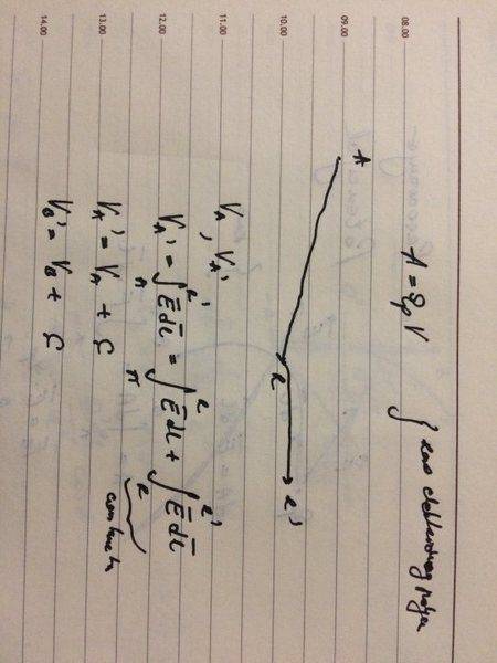

I don't exactly conceptually understand what the potential is. The electric field is a vector at a given point from the charge that describes the strenght and the direction of the fields. Potential is given as a potential of a point in referenve to another point in spave? I have uploaded the picture od a segment of my lecture today where it discribes that there exists a constant in the potential formula which dissapears when we introduce the potential difference..
3. The Attempt at a Solution [/B]
Can someone give a little insight in what it is if you understand what i mean? The potential of a point A is known but the potential of A' is potential of point A plus some constant which is electric field line integral from R to R'. How is that constant if R' is arbitrarily chosen?
the potential of A' is potential of point A plus some value which is electric field line integral from R (position of A) to R' (position of A').
So R' is not arbitrarily chosen but the path from A to A' can be arbitrarily chosen.

So let's say we have a charge ##q## and a point ##A## in space whose potential is ##V_A=\frac{Q}{4πε_or_A}## where ##r_A## is the vector from ##Q## to ##A## .If the above is also true for ##B## but with ##r_B## then the potenital defference between these two is some value ##V_{B-A}=\frac{q}{4πε_or_{B-A}}## What good is this expression? What use do we have of this? The potential difference between those two points..?
If A has ##
V_A=\frac{Q}{4πε_or_A}## and B has ##
V_B=\frac{Q}{4πε_or_B}## then the potential difference between these two is of course $$
V_B - V_A = \frac{Q}{4πε_or_B} - \frac{Q}{4πε_or_A}$$
Which is the energy per charge needed to bring a charge from A to B
