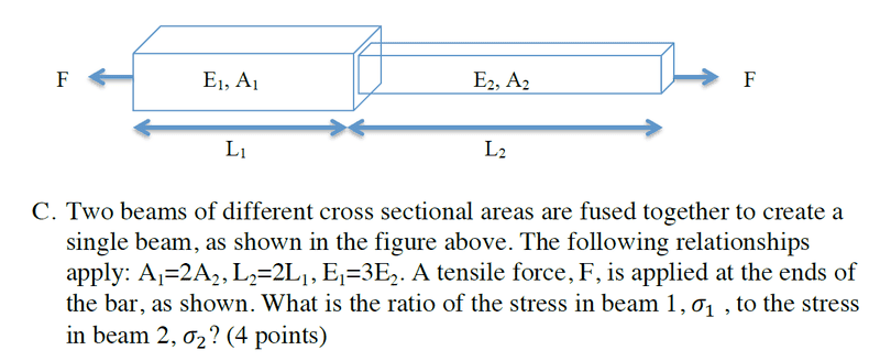

Diagram of two bars joined end to end along one axis, each pulled by a tensile force F at its free end; the left bar is labelled E1, A1 with length L1 and the right bar is labelled E2, A2 with length L2, with the left bar drawn thicker.
Two beams of different cross sectional areas are fused together to create a single beam, as shown in the figure above. The following relationships apply: A1 = 2A2, L2 = 2L1, E1 = 3E2. A tensile force F is applied at the ends of the bar, as shown. What is the ratio of the stress in beam 1, σ1, to the stress in beam 2, σ2?
stress = σ = F/A0
strain = ε = ΔL/L0
σ = Eε
σ1 = F/A1 = F/(2A2)
σ2 = F/A2
σ1/σ2 = 1/2
I think that my answer is probably wrong because I don't think that the force being applied to the beam should just be equal to F. Is the force at the location of fusion different from F that's being applied at both ends? How would I go about calculating this force? Would this make the F in the formula for stress an average of F and the stress at the fusion point?
Your answer is correct. In a real situation, the stresses in the vicinity of the fusion cross section would vary a lot with spatial position within the beam (you were very perceptive in recognizing this). But, at distances of only one or two cross section diagonal lengths away on either side of the fusion cross section, the stresses would become uniform and purely axial. So this is the state of stress that would prevail throughout most of the two pieces.

So when a tensile force is applied to a beam, this force is generally uniform throughout its cross section and does not vary with the length or mass of the beam?
No. You can take a cut thru the cross section of the beam at any point along its length and make a free body diagram out of the pieces. The forces which are required to keep the beam in equilibrium can then be used to calculate the axial stress.
How would axial stress be calculated? How would this differ from the stress used in the problem?
So if the force is different at each cross sectional area due to the length and mass of the beam, then why isn't the force for the beam with area A1 different from the force for the beam with area A2? Shouldn't this mean that the force providing the tensile stress isn't equal to F?
I suppose the tensile force is only being applied in the x direction, whereas forces caused by the mass of the beam would be in the y direction, causing them to not affect each other. But I know I've seen other beam problems before where the beam is fixed to a wall and an object is placed on it, and the distance of the object from the wall affects the force, but it's not affecting a tensile force in that situation, it's affecting the force in the y direction.
