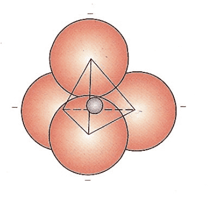

^^^^^^^^^^^^^^^^^^^^^^^^^^^It's a silly title, but I really need help. The four pink balls surround the purple one and all make contact.
Calling the radius of the purple ball r and the radii of the pink R:
Show that r/R=.225.
I think that this can be done with simple plane trig, but I am having troubles with the visualization.Anybody have any ideas? I am dying here.
edit: I hijacked this image to simplify the problem. The original problem statement had no image and came from a Materials Science text: "Show that the minimum cation-to-anion ratio for a coordination number 4 is .225"

As to the geometry I think you have to figure in several dimensions. But as I visualize it you can go a plane at a time.
For instance you know that the radii constrain the tetrahedral sides to be 2R.
From that I would examine the plane that intersects 2 spheres and the centroid of the tetrahedron, which is where the purple sphere is centered.
The centroid distance to a vertex - R is the radius of purple guy isn't it?
Okay LP. So I think I get you. r+R=height correct ?
And length = 2R
I am just not sure how to relate this to an angle?
I tried (r+R)/2R =sin 45
but this does not work. The angles should be 45 right?
The line from a vertex to the centroid of the opposite face passes through the centroid of the tetrahedron.
It has the delicious property that it is in a ratio of 3 from the vertex to 1 from the opposite face. This 3:1 ratio is quite useful.
Because we can apply that to the height of the tetrahedron which we know (from looking it up) is (2/3)½*(a) = (2/3)½*(2R)
I think that means that r = (3/4)*(2/3)½*(2R) - R

If h= r + R and h = (2/3)1/2*2R
then r + R = (2/3)1/2*2R
what detail am I missing?
That comes from the 3:1 ratio of the distance from the vertex to the centroid of the opposite face.
1+1+1 : 1 is 3/4 of the way doesn't it?
That locates the position of the tetrahedral centroid.

That doesn't look right! You should not be able to solve for R and r, only for the ratio r/R. Using a somewhat different method than you, I get [tex]\frac{r}{R}=\frac{\sqrt{6}-2}{2}\approx0.224745[/tex]
What I did was assign a coordinate system such that the center of the purple sphere is along the positive z-axis, 3 of the pink spheres lie in the x-y plane (with one having its center along the positive y-axis) and the 4th pink sphere's center lies along the positive z-axis. I then analyzed the 3 coplanar spheres, finding their equations, then found the equation of the 4th pink sphere, and finally the purple sphere.

That is apparently the same as the earlier answer.
r = (3/4)*(2/3)½*(2R) - R ;; algebraically simplifies into your result.
