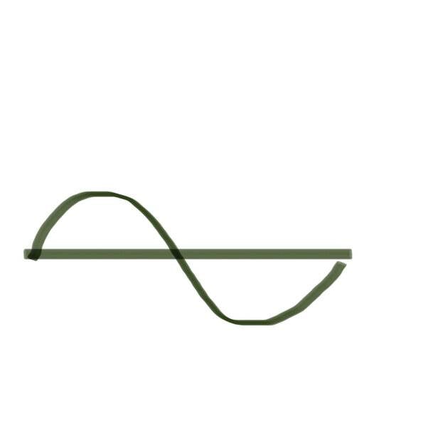

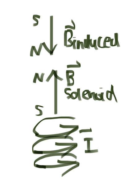

Not a homework question, but not understanding how jumping ring works with AC current
NA
From what I understand, when the current is increasing(in the first quarter of the graph I drew), there is an increase in magnetic flux assuming that the current goes in the direction I drew in. That means the current induced in the ring is going to create a magnetic field trying to oppose that change, ie decrease the magnetic flux. So it’s going to point down, which means the two north poles of the two magnetic fields are facing each other, so the ring experiences a repelling force, so it goes up. But when the current is decreasing(in the second quarter of the graph I drew), there is now a decrease in magnetic flux, so the induced current in the ring is going to create a magnetic field such that it tries to increase the flux? But then that would mean the south and the North Pole of the magnetic fields are facing each other, so the ring will get attracted and not fly up anymore? Or is it because since now the ring is flying up, the decrease in flux is so small so that the attractive force becomes negligible?

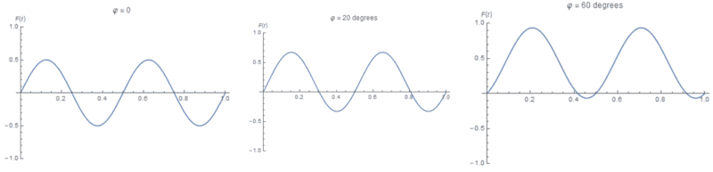

I wouldn't say that the downward force is necessarily negligible. It depends on the amount of phase lag ##\varphi## of the induced current. Here are some plots for the force vs. time for one cycle of the solenoid's B field. Positive values of the force indicate upward force on the ring.
Three plots of force F(t) against t from 0 to 1 over one cycle: at phi = 0 the curve oscillates symmetrically about zero; at phi = 20 degrees the upward peaks are larger; at phi = 60 degrees the upward peaks dominate.
The first plot is for no phase shift (##\varphi = 0##). In this case, force averages to zero over one cycle. As ##\varphi## increases, the positive (upward) force dominates more and more. The vertical scales of these graphs are arbitrary. But the graphs do show the fraction of time that the force is upward in each case.
These graphs are for the case where the ring is held at a fixed height. When the ring is in vertical motion, there are other complicating factors as shown in the paper that @kuruman references. But, I think the main reason why the average force is upward is the phase shift ##\varphi##.

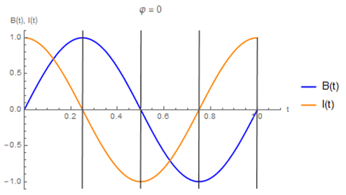

The "current lag" is the phase shift of the induced current in the ring due to the self-inductance of the ring. It is given by the phase angle ##\varphi## in post #3. If the magnetic field of the solenoid varies with time as ##B(t) \sim \sin(\omega t)## then the induced current in the ring varies as ##I(t) \sim \cos(\omega t - \varphi)##.
If there were no self-inductance, then ##\varphi = 0##. The graphs of ##B(t)## and ##I(t)## for this case are shown below.
Graph titled φ = 0 of B(t) and I(t) against t from 0 to 1: blue sinusoid B(t) starts at 0, peaks at 1.0 near t=0.25, crosses zero at 0.5, reaches -1.0 near 0.75; orange I(t) starts at 1.0, crosses zero at 0.25, reaches -1.0 near 0.5, returns to 1.0 at t=1.0. Vertical lines at quarter-cycle points.
I've chosen positive directions for ##B## and ##I## such that the force on the ring is upward when ##B## and ##I## have the same sign and the force is downward when they have opposite signs. The vertical lines separate the regions of upward force and downward force. For the first quarter of a cycle, the force is upward, for the second quarter of a cycle it is downward, etc. This is the case you were describing in your first post. The average force for a complete cycle is zero.

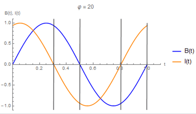

However, ##\varphi## will not be zero due to the self-inductance of the ring. This causes the current in the ring to "lag" behind the case where ##\varphi = 0##. For example, the graphs for ##\varphi = 20^o## are shown below
Line graph titled φ = 20 of B(t) in blue and I(t) in orange against t from 0 to 1.0, both sinusoidal with I(t) shifted right; vertical lines mark crossings.
Note how the graph of the induced current is now shifted to the right a bit. This means the current is lagging behind what it was when ##\varphi = 0##. The vertical lines still separate regions of upward and downward force on the ring. You can see that now the force is upward more than downward during a cycle.

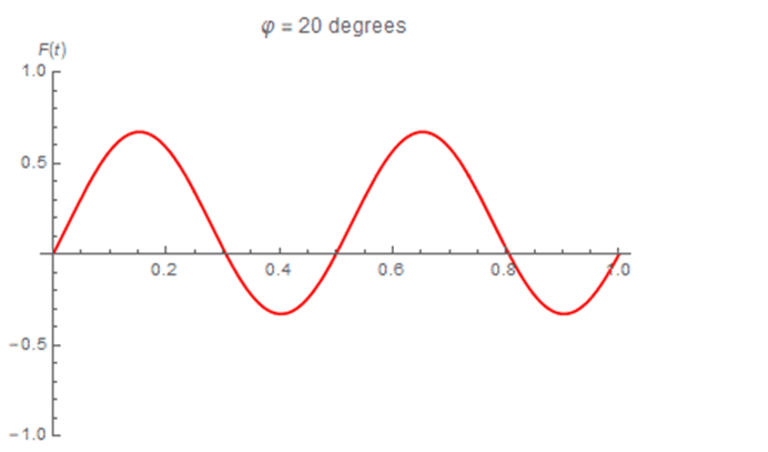

The force on the ring is proportional to the product of ##B(t)## and ##I(t)##: ##F(t) \sim \sin(\omega t) \cos(\omega t -\varphi)##.
So, a plot of the force on the ring for ##\varphi = 20^o## for one cycle of the solenoid's magnetic field looks like
Plot titled φ = 20 degrees of F(t) against t from 0 to 1.0, a red sinusoid starting at zero, peaking near 0.67 around t = 0.15, dipping to about -0.32 near t = 0.4, and repeating with a shorter period.
Positive force corresponds to upward force.
