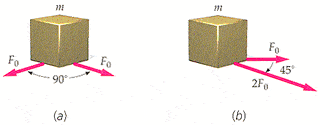

A force F0 causes an acceleration of 20 m/s2 when it acts on an object of mass m sliding on a frictionless surface. Find the magnitude of the acceleration of the same object in the circumstances shown in each figure below.
I cannot figure out how to do this problem without knowing the mass. Can anyone help?
  • Two diagrams of a block of mass m on a frictionless surface: (a) two forces F0 pulling outward from its bottom corner at a 90 degree angle; (b) a force F0 and a force 2F0 at 45 degrees, both acting on the block.

Hint: Just call the mass m, and do all the equations as usual …
you'll find that you can cancel the m's in the end! :smile:
