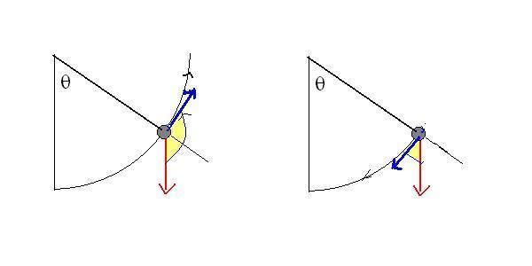

Trying to derive the work and kinetic energy from principle ie ∫force⋅ds, for a pendulum, with θ at the vertical.
∫force⋅dx
I toke the ∫mgsin(θ)⋅ds as the displacement and direction of the gravitation is opposite leading to the dot product - ∫mgsin(θ)ds,
ds=Rdθ
then the answer is mgR(cos(θ) - cos(θ(0)) , θ(0) is the initial, which makes sense since the path downwards leads to a positive number which corresponds to a increase in kinetic energy at the bottom.
But its when you take the path where the direction of the displacement and force are the same that you
get the integral - mgR(cos(θ) - cos(θ(0)). Which corresponds to opposite of the correct answer, ie loss of kinetic energy at the bottom of the pendulum...
So i don't really understand how to interpret this ? I thought the answer would be the same regardless of the direction you pick to go, you should have got an answer which was correct both ways like the first result.

For concreteness, let's say theta is measured anticlockwise from the vertical. The tangential force is ##mg\sin(\theta)##, and it always opposes the displacement, so ##r\ddot\theta=-g\sin(\theta)##. (There's no Coriolis term because r is constant.)
Integrating, ##\frac r2 {\dot \theta}^2 =g\cos(\theta)-g\cos(\theta_0)##, where ##\theta_0## is the angle at which the speed is zero, i.e. ##\theta_{max}##.
Now, where do you see a problem?

The change of KE is equal to the work done, and work is displacement times force times the cosine of angle between them.
See attachment:: the red arrow is the force (gravity) and the blue arrows represent the direction of infinitesimal displacement. What is the angle between displacement and force when the pendulum moves in the direction θ>θ0 and when it moves in the direction θ<θ0 ?
it would be mgRcos(θ+pi/2)dθ for the the first and the second is mgRcos(θ-pi/2), which are equal to -mgRsin(θ)dθ and mgRsin(θ)dθ.
Well done. What is the work in both cases?

I do not see any problem with work. What work is done when the pendulum moves from 0 to some angle θ, or from some angle to zero
angle? You need to include the cosine of the angle between force and displacement which is not the same in those two cases.
the first is mgR(cos(θ) - cos(θi)) and the second is -mgR((cos(θ) - cos(θi)) the second gives a negative kinetic energy for the change from a higher θ to a lower θ(like from pi/2 to 0), is that correct?
its odd to me because in the second case you are expecting the work to be positive since at the bottom of the swing there is a maximum velocity and so the intial velocity should be smaller then the final leading to positive work integral.
In the second case ##W= \int_{\theta_i}^{\theta_f}{mg\sin(\theta) ds }## with ds= - Ldθ. So ##W=- \int_{\theta_i}^{\theta_f}{mgL\sin(\theta) d\theta }=mgL(\cos(\theta_f)-cos(\theta_i)) ## positive if θf< θi

If you are considering theta starting at ##-\theta_{max}## and increasing to zero then ##d\theta## is positive and the force is positive, so the integral is positive. If you take theta starting at ##\theta_{max}## and decreasing to zero then ##d\theta## is negative and the force is negative, so the integral is positive.
