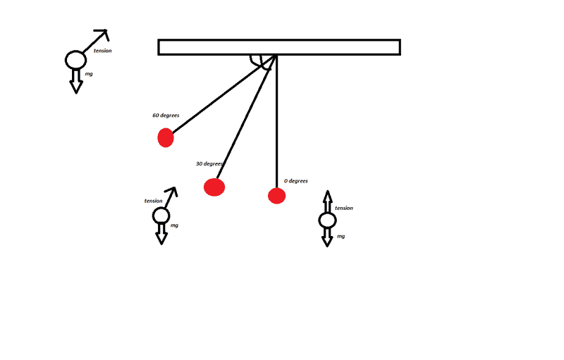

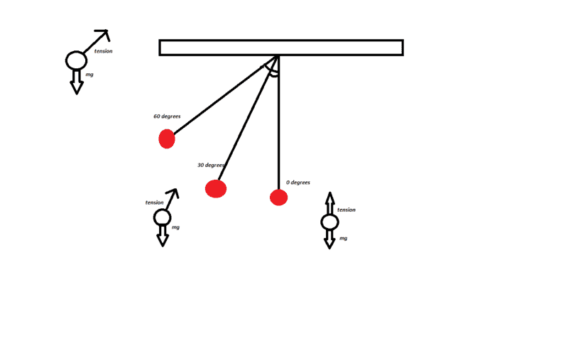

A mass of 200 g is attached to the end of a cord 1.20 m long. The cord is hung from a horizontal beam and the mass is free to swing making a pendulum. The mass is released from rest at an angle of 60° from vertical. What will be the velocity of the mass at an angle of 30°, and at an angle of 0°?
F_c = m(v²/r)
I figured that since it seems to be traveling in a half circle type of movement...I could use the fact that the length of the string would be the radius...so 1.20m
after that I did
ƩF_y = ma_y
mgcosθ = m(v²/r)
the m's cancel so
gcosθ = v²/r
v = √(rgcosθ)
And I figured that I could use that same equation to solve for each of the angles...i.e
= √((1.20(9.8cos60))
= √((1.20(9.8cos30))
= √((1.20(9.8cos0))
Would this be correct? Or am I totally off here?
you are on the right track but the angles marked on your diagram are wrong !
You need to sort that out to make sense of your equations

Right, sorry about that I'm just so used to doing it "from horizontal"
You are on the right track.
A good check is to look at the extremes...when angle = 0, Cos0 = 1 and the velocity should be max...which it is !

You're quite far off.
How do you get that mgcos(θ) is equal to the centripetal force? It's not.
mgcos(θ) = m v2/r can't possibly work, because for instance, at the instant that the mass is released, the velocity is zero, but θ = 60° .
Use conservation of energy.
Right, makes sense...the lowest point here would be the max velocity. Just like if the angle was 90° the velocity would = 0.
So okay then my equations would be correct?
= √((1.20(9.81cos60)) = 5.886m/s
= √((1.20(9.81cos30)) = 10.19m/s
= √((1.20(9.81cos0)) = 11.77m/s ( which would be the max velocity )
Look about right?

Oh..then they are not correct.
Well okay...assuming that this system is frictionless then W = 0
It goes from Gravitational P.E to Kinetic Energy so
mgh = 1/2mv²
m's cancel so
gh = 1/2v²
rearrange for v
V = √(2gh)
and h would be 1.20cosθ here?
How do you get that mgcos(θ) is equal to the centripetal force? It's not.mgcos(θ) = m v2/r can't possibly work, because for instance, at the instant that the mass is released, the velocity is zero, but θ = 60° .
The angle θ = 60 for the pendulum diagram corresponds to (ωt) = 90 (the release point) in the equivalent circular motion and the amplitude A = LSinθ, ie A=LSin(ωt)
mgCosθ = mv^2/r = centripetal force is correct.
mgCosθ = ma where a = centripetal acceleration (v^2/r)...r = length of pendulum

the source of the problem is that the angle you use to describe the pendulum is not the angle that occurs in SHM equations.
Your 60 is 90 (or 0) in the SHM equation
