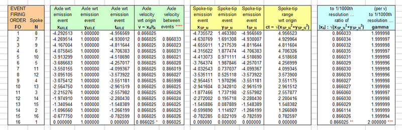

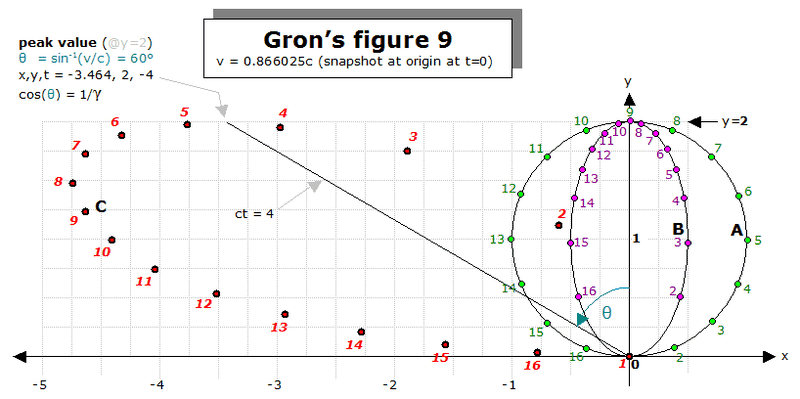

That is verified by the axle velocity between events in these 2 images from this thread. https://www.physicsforums.com/threads/rolling-rings-in-sr.920107/
The thread shows a solution for Grøn's Fig. 9 part C relativistic rolling ring problem. The points on the rim are considered to be in the same locations as the tips of length contracted wheel spokes. This solution removes Born rigidity concerns by making the wheel have zero thickness (z=0) while using a wheel frame an axle frame and a road frame (to plot the emission point locations).

I have not compared the data you listed to that generated by my program, but the diagram looks consistent with my video of the Car with Observer on the road. Kudos.
