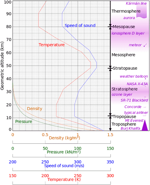

It appears I was somewhat mistaken. The speed of sound appears to depend a great deal on temperature. See the following picture from wiki's article on the speed of sound:
Density and pressure decrease smoothly with altitude, but temperature (red) does not. The speed of sound (blue) depends only on the complicated temperature variation at altitude and can be calculated from it, since isolated density and pressure effects on sound speed cancel each other. Speed of sound increases with height in two regions of the stratosphere and thermosphere, due to heating effects in these regions.
Atmospheric profile plot against geometric altitude in km (0 to 100), showing density, pressure, speed of sound (m/s) and temperature (K) by altitude, with layer labels from troposphere to thermosphere.
