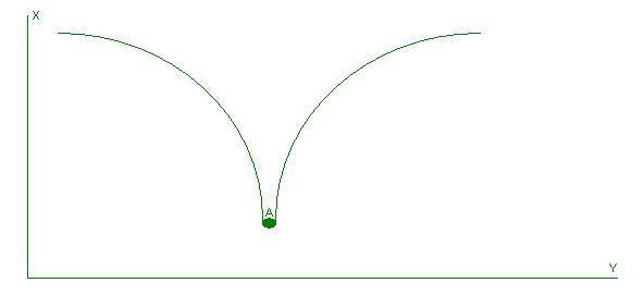

Also curved space time looks, in 2D, like a funny shaped funnel or cone. How do you consturct (pictorially or mathematically) a similar cone in all three dimensions such that light entering from any angle will travell in a geodeisic path? For this to be true the light would have to take a geodesic path regardless of the angle of attack! I find difficulty with this as if you take a single cone shape and rotate it thru all dimensions, cone 1 overlaps cones 2,3,4,5,6,7 etc etc and the cone shape, density, morphology, topology is compeletly destroyed?
Strictly speaking the "funnel" picture of a black hole illustrates only the curvature of space, not the curvature of spacetime.

harryjoon said:
Therefore, could we not conclude that the worldline of ONLY those objects, which are in a stable orbital path such as planets in orbit around the sun, orbiting satalites etc., corresponds to a geodesic of the curved space-time produced in the presence of the a mass, i.e only planetary objects free-fall along a geodesic in their worldline.
No, any small object in free-fall (again, I'm not totally sure about large objects which contribute significantly to the spacetime curvature themselves) stays on a geodesic as long as it is not being acted on by non-gravitational forces. For example, if you jump into the air and we neglect air resistance (perhaps you are jumping on the moon), then for the period when you're not touching the ground, you are following a geodesic, but as soon as you hit the ground electromagnetic forces between the atoms of the ground and the atoms of your feet cause you to stop following this geodesic path (if you were made out of neutrinos you wouldn't have any electromagnetic interaction with the ground so you'd continue falling right through on something close to a geodesic, although it wouldn't be perfect because there is still some interaction of neutrinos with other particles via the weak force).
The easy way to determine if you are on a geodesic experimentally is to use an accelerometer. As long as your accelerometer reads 0 you are on a geodesic. Of course, if you are on a geodesic that intersects with the Earth you will abruptly leave said geodesic and the accelerometer will register a very large acceleration. But while the accelerometer reads 0 you are on a geodesic.
That is incorrect in two ways.
If we consider a system with test object T orbiting a test mass M then their geodesics always intersect (except for cases with a positive cosmological constant). Second under no circumstance will the accelerometer register anything, except for the moment when T crashes onto M.
Note that geodesics are spacetime paths not paths in space parameterized by time.
Which is the moment that T leaves the geodesic.
