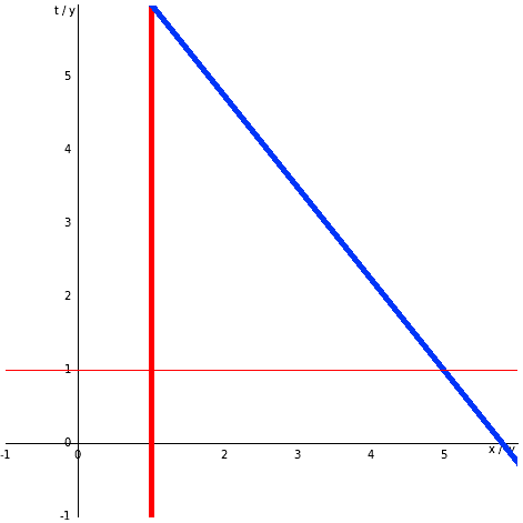

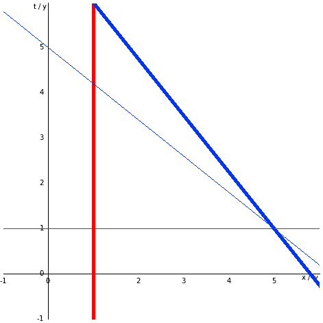

Here's a spacetime diagram showing Tom and Mary. It's drawn using Tom's frame, so Tom is at rest.
If you haven't come across spacetime diagrams before, they are "maps" of spacetime, with time (as defined in this frame) drawn up the page and space (again, as defined in this frame) across it. Tom, therefore, appears as a vertical line (red on the diagram) because he doesn't change his position in this frame. Mary is a slanted line (blue on the diagram) because she is moving. Notice that Tom has been placed at 1ly, and Mary reaches 4ly from him at t=1. Let's add a line showing Tom's idea of "all of space at the moment that Mary is 4ly away from him":
Tom's idea of space is the fine red line, and you can see that Mary is 4ly away. However, Mary does not share this definition of "space" because she does not share the same notion of "at the same time". Her version of "all of space at the same time" is shown as a fine blue line here:
Notice that the fine blue line passes through Mary at the same time as the red line, but it does not pass through Tom at the same time as the red line. This is why they measure different distances - they are measuring along different slices of spacetime, and they are doing that because they don't share a notion of "at the same time". The interval along the fine blue line between the two thick lines is 2.4 ly.

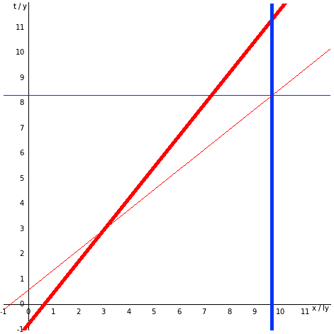

To complete the picture, we can also draw the same graph in Mary's frame:
Now Mary is represented by a vertical line and her "all of space" is a horizontal line. You can read off the horizontal axis that the spacing is 2.4 ly, but again, Tom is measuring something different.
Your problem is that you keep hoping you can pretend the different slopes of the two fine lines don't matter. They do.

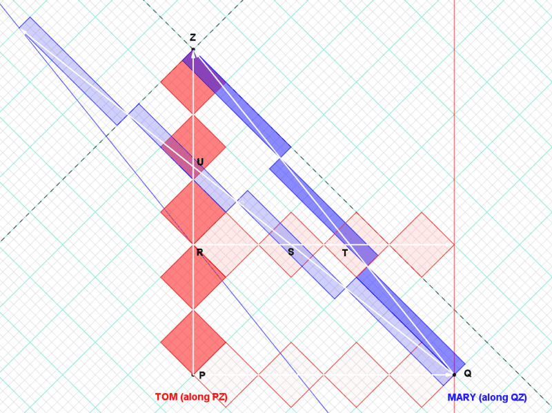

In addition to the diagrams of Ibix, one can choose a frame in which Mary and Tom are moving with same speed in opposite directions, which makes the situation look more symmetric.
On the following image, the thick blue line is the worldline of Tom and the fine blue lines denote simultaneous events in Tom's frame, while the thick red line is the worldline of Mary and the fine red lines denote simultaneous events in Mary's frame.
The markings on the fine blue line connecting Tom's time 0 to Mary's worldline tell you that this distance in Tom's frame is 4 at Mary's time 0.
The markings on the fine red line connecting Mary's time 0 to Tom's worldline tell you that this distance in Mary's frame is contracted to length 2.4 at Tom's time 3.1.
The markings on the fine blue line connecting Tom's time 3.1 to Mary's worldline tell you that this distance in Tom's frame is contracted to 1.44 at Mary's time 1.9.
The markings on the fine red line connecting Mary's time time 1.9 to Tom's worldline tell you that this distance in Mary's frame is contracted to 0,864 at Tom's time 4.4.
The markings on the fine blue line connecting Tom's time 4.4 to Mary's worldline tell you that this distance in Tom's frame is contracted to 0,5184 at Mary's time 2.6.
etc.....
...which is particularly powerful in this case, because it illustrates where the symmetry is and is not in this scenario. You could easily extend Mary's line downwards another two years and draw left-right reversed versions of the fine lines, and then the diagram would be symmetric. But @dwspacetime chose not to do that (and actually only considered the two fine lines through Mary's zero event), so had an asymmetric setup. That choice is why the scenario (not the physics, just the setup) prefers Tom's rest frame.

Here's a spacetime diagram on rotated graph paper, following the color scheme of @Ibix in #20 .
You can count the diamonds to find
QU is a spatial displacement of length 2.4 in Mary's frame
and
RT is a spatial displacement of length 2.4 in Tom's frame.
(Note that from similar-triangles ([itex]\frac{PQ}{PZ}=\frac{4}{5}=\frac{2.4}{3}\frac{RT}{RZ}[/itex]).)
