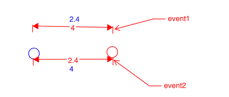

dwspacetime said:
no matter which event happens first one of them is going to have 2.4 lys before 4 years why
This is simply wrong. This is not a proper spacetime diagram. The proper spacetime diagram was posted by me above. Please refer to that instead of making up your own faulty notions. Your diagram completely fails to account for the relativity of simultaneity. You will simply never understand relativity without a proper understanding of the relativity of simultaneity. Instead you will get lost in a quagmire of imagined paradoxes.
Note in the actual diagram how the blue and red lines do not coincide! They have different slopes. This is the relativity of simultaneity.
It is true that the event where C and D meet on M and the event where C’ and D’ meet on T have spacelike separation. This means that the order in which they will happen is going to depend on the reference frame - again relativity of simultaneity! In the frame I based the diagram on they both occur at the same time due to symmetry.
However, in T’s frame CD occurs before C’D’ but in M’s frame C’D’ occurs before CD. This must also be the case due to symmetry.

dwspacetime said:
that tells me that depending on which inertia frame you are in the sequence of events could be reversed.
That is correct; the time ordering of spacelike separated events is frame dependent.
dwspacetime said:
the reason for something to happen could be the result.
No, it can't, because spacelike separated events in relativity can't be causally connected. Neither can cause the other or be an effect of the other.
dwspacetime said:
the universe is wrong. sorry
That would make a great title for a book:
Sorry, The Universe is Wrong (the thoughts of a science skeptic)
By definition the Universe is right. Whether that conforms to one’s own prejudice or not is a different matter. The Universe is in no way obliged to make itself easy to understand.
