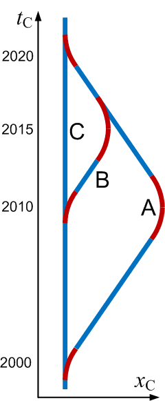

Experiencing the "same acceleration" does not mean they should age the same amount, though, it has to do with the overall geometry of their paths through spacetime. To illustrate, here is a nice spacetime diagram created by DrGreg:
Here we have three objects A, B, C, with C moving inertially while A accelerates away from C and B in 2000, then B remains at rest relative to C until 2010 when B also accelerates away, then later B and C both accelerate back towards A and finally accelerate together to come to rest relative to C in 2020. In this case B and C both have three periods of acceleration which each last the same amount of time and involve the same G-forces, but C will have aged less than B in this case (and of course both age less than A). There is a close analogy between the geometry of paths through space and paths through spacetime--just as a straight-line path through spacetime (like C's) always involves the most aging, a straight-line path through space always has the least distance. And just as B's aging is closer to C's than A's, so the spatial length of path B on the diagram is closer to that of the straight-line path C than path A's spatial length is. For a detailed discussion of the analogy between the time of paths in spacetime and the lengths of paths in space, see [post=2972720]this post[/post].
