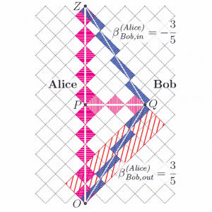

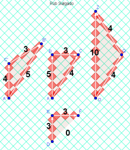

robphy said:
Have you looked at some of the PhysicsForums Insights?
I just took a look. I think at my level it will take me time to understand. It uses hyperbolas which is complicated for me. Even the two dimensional graphs present me some problems! For example, in a stationary frame's coordinate system, the X and Y axis are at a 90 degree angles from one another like we usually see. If another frame is moving relative to the first coordinate system, its X and Y axis will be bent inward. Wont the person moving, however, see their X and Y axis the same way the person in the first frame saw his axis (i.e. at 90 degree angles from one another)? I'm assuming its the person in the stationary frame that sees the person in the moving frame as having tilted axis?
Epstein, for the first few chapters, helped a lot. I stopped understanding when he got into the twin paradox.
The hyperbolas are there, just like circles are there in Euclidean geometry.
However, the insights I referred to don't make explicit use of the hyperbolas.
In my case, I have developed an alternate structure to encode the hyperbolas.
The result is an accurate, physically-motivated visualization of the time elapsed along a piecewise-inertial worldline
without explicitly using the Lorentz Transformation formulas.
In my opinion, 2D graphs are essential. (Doing geometry with just words is difficult.)
In fact, you can play with a GeoGebra file I created for a talk:
https://www.geogebra.org/m/HYD7hB9v#

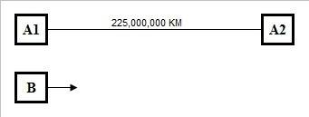

Well the example got me thinking: Say A and C are two 30 year olds in their IFR, and they are standing the same distance apart like A and C in PeroK's example. When B is at rest relative to A and C, he will also see them as both being 30. Now, if B starts going at at a fast enough speed, and the time it takes him to reach that speed is near instantaneous, then it's possible that he'll see C as a 90 year old and A as still being 30. Also, if I understand it right, C himself would see himself as a 30 year old when B would see him as 90! Does that mean that if someone flew by me fast enough they'd see me as a 90 year old??
Mister T said:
Time doesn't rotate. The time axis rotates as shown in the diagrams. The reason has to do with the way you draw lines of constant time, they take into account relativity of simultaneity. Two events that are simultaneous are connected by a line of constant time. But if you are moving relative to me, my line of constant time and your line of constant time are rotated relative to each other because events that are simultaneous to me are not simultaneous to you.
Thank you for clarifying this. I am going to need to learn the rules for drawing the diagrams (e.g. what the relationship is between the speed of the moving frame and the angle that the axis shifts.
You're still making two fundamental mistakes. The first is that these things are not what you "see", but the results of measurements. The second is that the lack of synchronicity is due to the distance between A and C: B cannot be in both places at the same time. So, B can never directly observe A (locally) and C (locally) at the same time.
The way I would think about this is to have a fourth person, D, at rest with respect to B. So that B and D share an IRF and D passes C "when" (in the B-D IRF) B passes A. Let's move away from the twin paradox for a moment and assume that B and D have established that they are at rest with respect to each other and (from their perspective) A and C are 2.4 light years apart and moving towards them at ##\frac{4}{5}c##.
Now, B records the time on A's clock when he passes A; and D records the time on C's clock when he passes C. Then, they communicate the results to each other.
B communicates: "I passed A at ##t_B = T## (say) and A's clock read ##t_A = 0##.
D communicates "I passed C at ##t_D = T## (this establishes that B was at A when D was at B - in the B-D frame) and C's clock read ##t_C = 3.2 years##
This constitutes a "measurement" in the B-D frame of the lack of sychronicity of the A-C clocks. Neither B nor D can do it easily by themselves, but between them they can carry out this measurement.
Meanwhile, A and C measure their clocks as synchronised in their frame and, in their IRF, B passing A and D passing B were events that were 3.2 years apart. In other words: simultaneity is relative.
I suggest you go back to your textbook and master ROS. I don't think one can "half" understand ROS: you either understand it completely or you don't!
Go back and read Einstein's train example showing the relativity of simultaneity again. Instead of the lightning strikes, we have passengers A and C celebrating their 30th birthdays at each end of the train, and B is the observer on the train, in the middle. B accelerates by jumping off the train and ending up at rest on the platform.
And then back to your spaceships...

If I may share my experience with understanding SR. You have to solved it yourself.
For solving Twins Paradox, you only need very basic Lorentz Factor and high school math.
The very basic rules to solve Twins Paradox are these:
1. The parties should travel in constant speed, no acceleration involved. After you have mastered Twins Paradox, then you can study SR with acceleration involved.
2. Rest and travel are abstract things in SR. A "rest" observer will see that the "traveling observer" is (of course traveling), and the "traveling observer" will see that it is the rest observer who is traveling.
3. A "rest" observer will see the "traveling" observer's clock dilated.
4. Rule 3 will also appliy to the "traveling observer". The traveling observer will see that the "rest" observer's clock dilated.
5. Ignore Time dilation for this problem, first. We only use Doppler effect. But later to understand Twins Paradox, time dilations play a very important role.
Okay..., so let's begin our thought experiment. No Time dilation for now.
Use doppler's effect or your logic.
Two observers A and B
A stays and B moves 0.6c to the west. And in B frame, it's B who stays and A travels 0.6c to the east.
The distance between B and A2 is 225 millions KM (in A frame).
A1 keeps sending signal every 1 milli second (in A Frame) to B and B keeps sending signal every 1 milli second (in B Frame) to A1.
When B reach A2 (both frame agree with this event) B turns around and heads back to A1 at 0.6c.
So the question is this:
1. Before B reaches A2 how many ticks per second (ignore time dilation, ignore time dilation) that B receives from A1 and how many ticks per second that A1 receives?
2. The moment B reaches A2 and turns back to A1, how many ticks per second that B receives and so does A1? (ignore time dilation, ignore time dilation)
You might want to solve this yourself, to under Twins Paradox I think.
Then we analyze further the Doppler effect, then the combination with time dilation.
