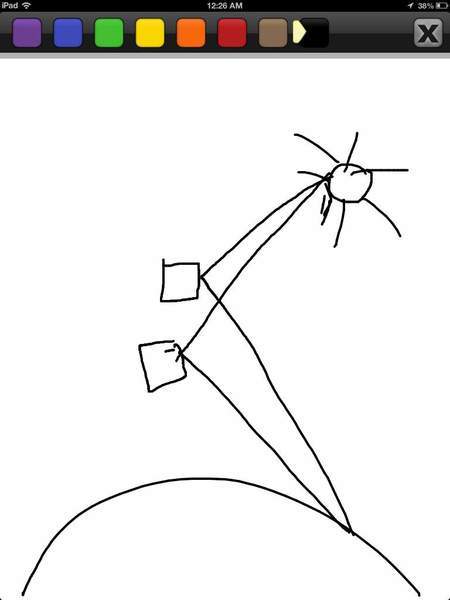

Here is a picture. I apologize for my horrendous drawing skills, but I hope you get the basic idea. The sun shines two rays at two cubes, each of which reflects light to the same point.
EDIT: To clarify, are you saying that for any point on the retina, there's only one angle of incidence that light hitting that point can have?

angle of incidence = angle of reflection, so you made a mistake in that drawing (your top block ha a small angle of incidence and a large angle of reflection).

That's just bad drawing on my part. But that can be easily remedied by rotating the block a bit, so that the rays I've drawn will obey angle of incidence = angle of reflection.
if you rotate the block, you are now getting the source from a different point on the sun :)

No, you aren't. I'm keeping the location on the sun fixed, and I'm keeping the point of contact between the light beam and the block fixed, and I'm rotating the block about the point of contact.

That's exactly how lenses work, lugita. There are two distinct areas of confusion on your part. One is that you don't understand how lenses work. That other is that you apparently don't know how reflection, particularly diffuse reflection, works.

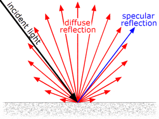

I'll start with reflection. There are two basic kinds of reflection, specular and diffuse. Specular reflection: That's how mirrors reflect light. "Angle of incidence = angle of refraction". Diffuse reflection: That's how many objects that occur in nature reflect light. In pure diffuse reflection, the light reflected from the surface is independent of the angle of incidence. The intensity depends on the angle with the outward normal to the surface. The following diagram depicts reflection from a surface that exhibits both specular and diffuse reflection:
Diagram of diffuse and specular reflection: a black incident light ray strikes a rough surface, scattering red reflected rays in many directions and a blue specular reflection ray leaving at the mirror angle.

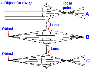

When you look at some point on an object, some of the light reflected by that point will enter your eye at the top of the lens, some will enter at the bottom, and so on. If the object is in focus, the light that comes from that point will converge on the same point on your retina, regardless of where it entered your eye. Another diagram:
Three ray diagrams of a lens: A shows parallel rays from a far-away object converging at the focal point; B shows rays from a nearby object diverging to a point beyond the lens; C shows rays from a nearby object converging farther away.
Diagram A shows how light rays emitted by a distance object such as a star enter your eye and are focused on the retina. The rays from that distance source are essentially parallel when they enter your lens. Your eye muscles have to shape the lens so that it focuses all of those parallel rays on a single point. Light from a different star will come from a different angle. That light from that other angle will be focused on a different point on your retina.
Diagram B shows what happens to light from a nearby object when the lens is shaped to focus far-away objects. The light from a nearby point does not converge on a single point on the retina. That nearby point is out of focus when you are looking at an object that is far away.
The eye muscles reshape the lens to make that nearby object come into focus. That's diagram C in the above image. Now light from a nearby point converges on a single point on the retina. Light from a different nearby point will converge on a different point on the retina. Now the distant objects that you were looking at become out of focus.
