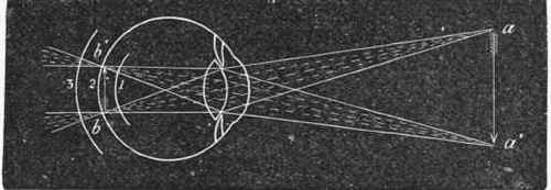

I was wondering how a uniform image is formed. If the eye is a point then I can visualize how an image is formed. But the eye isn't exactly a point. So don't light rays from all angles hit all spots on the retina? How is a uniform image formed? For example if we're looking in a plane mirror, we can see objects distinctly because there are only few rays connecting a point of the object to our eye whilst maintaining the laws of uniform reflection. But if the eye is extended then can't light rays from the ceiling and something in front of me reach the same point?

I still don't get how light from a point source is focused at only one point. Light from the point source can hit all points on the eye lens, and so will be focused at different spots on the retina. Obviously this is wrong as we can see distinctly only because light from a point is focused onto one point. I want to know how light from the point source, hitting all points on the eye lens, can be focused onto one point on the retina.
I did a bit of research. Tell me if this is right. Even if light from the point source hits all points of the lens, they ultimately converge somewhere at the other end. That distance depends on the material, curvature of the lens etc. and the rest is up to the brain. Is my basic idea right now?
A point source produces light in all directions, so you can draw concentric spheres around it and light hits the inside surface of the whole sphere. Point sources do not create just a point of light rays in one direction.
Which end you mean by other end, the camera end or the source end? At the camera end, they don't converge to a single point. Similar to the retina, there's a distributed area of sensors. The source is (approximately) a plane; a cross section in 3D space that you're looking at so it's not a single point either.

Maybe it would help to work 'backwards' from the retina- for any spot on the retina, there is a cone of light that will pass through the lens and pupil of the eye. In terms of geometrical optics, this cone of light will converge onto a single object point.
Different points on the retina correspond with different cones of light, all with about the same cone angle but oriented in different directions and converging on different object points.
Conceptually replacing the retina with a CCD is fine for analyzing the optical system (except the retina is curved, not flat) but obscures many essential features of 'seeing'- the retina is part of your brain, and the image formed on the retina is very different than what results after processing.
Thanks to everyone. I understand now.
