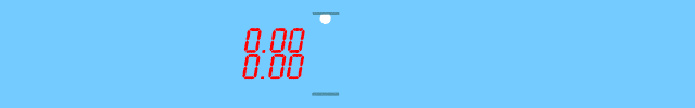

Suppose there is person A in a frame S with respect to which a light beam clock is at rest , now time taken by a photon to go from bottom to top is L/c according to A.
now the same clock is looked at by a person B traveling with velocity v w.r.t S and according to him time taken by photon to reach from bottom to top is L/c*gamma.
In this proof how can we know that when A's clock showed L/c second at that very instant B's clock didn't show L/c*gamma becoz that would mean something opposite to time dilation.
I mean showing the times the photon takes w.r.t different frames barely gives me an idea about time dilation PARAPHRASE=how does this proof incorporate the fact that B's clock is slow?HOW DOES IT PROVE TIME DILATION

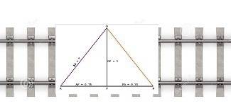

The clock in A's frame does not tell you what the actual time is (although all you need to do is synch a real clock up with it). In the derivation, frame B DOES NOT refer to any time calculations in frame A. All we are doing is calculating what each observer sees INDEPENDENTLY and then we compare them.
The two postulates of special relativity are covariance (inertial frames have the same physics) and universality of c regardless of relative motion. With these postulates it can be shown that time is dilated between inertial observers. In a rest frame, the photon bounces up and down in a straight line, 2L/c=τ being the period if the mirror separation is L. In a frame moving relative to this frame, the photon will appear to take a "zig zag" path. If Δt is the period of the clock in the frame moving relative to the stationary clock, then in time Δt the clock would have moved a horizontal distance of vΔt (v is the relative velocity). Now, vΔt is the base of the triangle formed from the full cycle of the photon bouncing. the two other sides are just the distance the light has traveled, and from the universality of the speed of light, this distance must be cΔt/2 for each side. Of course, the height of this triangle is just the separation of the mirrors, L. All you need to do now is apply basic geometry of right triangles. a2+b2=c2
Drop a perpendicular from the vertex of the triangle to the base. Two right triangles will be formed. The base is just vΔt/2, height is L, and hypotenuse is just cΔt/2 so
(vΔt/2)2+l2=(cΔt/2)2
or
(vΔt/2)2-(cΔt/2)2=L2
factoring out (cΔt/2)2 from both terms on the left side of this equation and taking the square root, we find
cΔt/2√(1-v2/c2)=L or Δt*1/γ=2L/c but 2L/c is just τ
Notice that, in deriving the time it takes for the photon to complete its motion in the moving frame, we made absolutely NO assumptions as to what the rest frame sees.

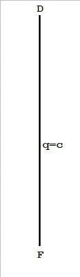

Perhaps it's better to show in a picture that I make before.
Don't worry if you don't grasp SR. I'm struggling, too :smile:
Supposed, a train, it's wide (not length!) is 0.5c
From your frame, the train is at rest.
If the train is not at the same frame with you who sit on a certain row, so the chair, desk, windows, everything will hit you inside.
And if you sit at F and light a signal to D and back to F, how many seconds pass according to you?
The length is 0.5c+05.c = c.
So, your watch shows 1 seconds, right?

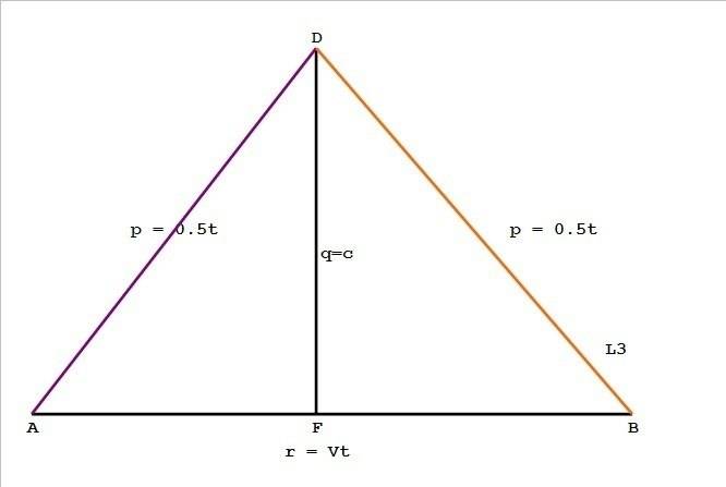

Sorry, should have brought a picture that conforms you calculation. But this is the only picture in my harddrive. Should redraw it and upload it again...
Can I answer?
I will answer what I know is true.
Perhaps the good mentors/advisors should step in if there's a mistake in my answer, so not to confuse Raman Choudhary
So, this is the more appropriate picture.

The wide of the train must be 300 thousands km. That's what time it takes for light 2 seconds to bounce from F to D and back to F.
For convenience, we say the length of Q is c in the unit of light second.
The speed?
PeterDonis said:
Meaning, we are using an inertial frame in which the light clock is moving at a velocity such that ##\gamma = 3##, correct? This means that ##v = \sqrt{1 - \left( 1 / \gamma^2 \right)} = 2 \sqrt{2} / 3##.[..]
Yep, ##v = \frac{2\sqrt{2}}{3}##
What does it tell you from this picture?
If you are at the train, you'll see the light travels something like this:
The light from the train frame travels at 2c bounce back. So your clock must have shown 2 seconds if you are in that train.
But if you are at the platform, you'll see that the train travels at ##\frac{2\sqrt2{}}{3}##, so you'll see the light forms two hypotenuses of two triangles
If you said ##\gamma = 3##, (and PeterDonis has calculated that ##v = \frac{2\sqrt{2}}{3}##),
So, ##t = 2 * \gamma = 6## seconds; ##AF = vt = \frac{2\sqrt{2}}{3}3 = 2\sqrt{2}##
The length of p? Simply ##0.5t = 0.5 * 6 = 3c##
Or using phytagoras.
##p^2 = c^2 + (2\sqrt{2})^2 = 1 + 8; p^2 = 9; p = 3##
So, from the platform frame, the light travels at 6c. So it takes 6 seconds for the train to travel from A to B according to platform frame.
This is the proof that clock at train frame runs slower than on the platform frame.

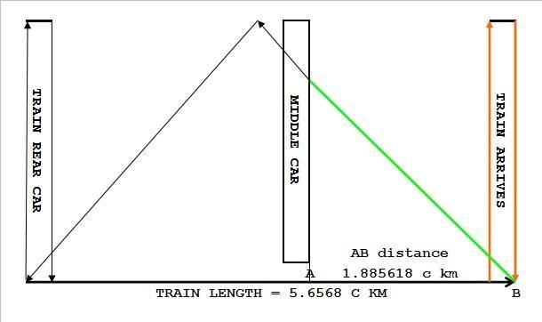

See this picture. What does it tell us?
Now, A also flashes it light along the rail width, perpendicular with the direction of the train, so we'll have the same situation.
T will see that A's light is slanted, of course T always see that T's light is straight, perpendicular to T's travel direction.
Now, when T Front (TF) arrives at B, TF will read its clock: 2 seconds.
How does TF see the light that's flashed by A? The light will be slanted, and 2 seconds is not enough for the light to bounce back from the other side of the rail to A.
In 2 seconds, the light only travels at the green part of the arrow, see picture.
T calculates the distance by pythagoras theorem.
The hypotenuse is, of course, 2 ls. Remember TF clock when it arrives at B read 2 seconds.
T speed is ##\frac{2\sqrt{2}}{3} = 0.9428c; \gamma = \frac{1}{\sqrt{1-\frac{(2\sqrt{2})^2}{3^2}}} = 3## from now on, we'll use decimals.
So in 2 seconds, A will be at 1.8856c.
Interestingly when TF arrives at B, A haven't reached Train Back/Stern (TB) car, somehow AB distance is length contracted.

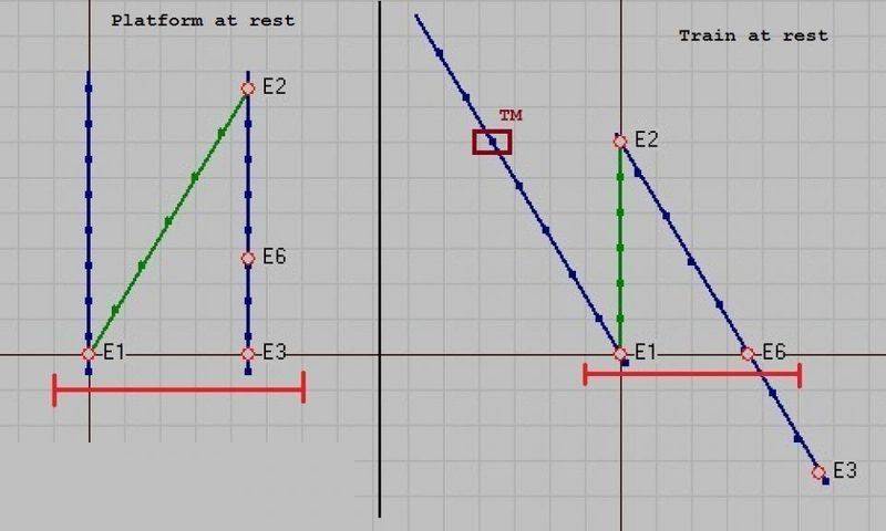

So, TF consult one of his car in the middle that is 1.8856 ls away from TF, let's call this middle car TM.
TF: "TM!, please read A's clock"
Remember, the hypotenuse is 2 ls, horizontal distance is 1.8856 ls, so vertical distance (D) is ##D = \sqrt{2^2-1.8856^2} = 0.667## seconds. A will see that the light only travels 0.667 ls after TF left, or after A flashed the light, so A's clock is 0.667 seconds
TM: "A's clock is 0.667 seconds" This is the most important clock time in our discussion
TF thought, "Funny, I left when A's clock reads 0 seconds, now when my clock (TF) reads 2 second, A's clock reads 0.667 seconds. Subtracting 0.667 - 0 = 0.667 (always remember platform's clock might not be synchronized with trains clock), so platform's clock is dilated by a factor of 3"
B thought: "Interesting, when TF arrives, my clock (B) reads 6 seconds and TF reads 2 second, A reports that when TF left, TF's clock read 0 seconds. Subtracting 2-0 = 2 (clocks might not be synchronized), so train's clock is dilated by a factor of 3"
This is the S-T diagram.
This diagram is not to scale!
V is 0.6 instead of 0.9428c. Because when you tranform it to rest, it disappear from the screen. Gamma factor is to big.
But the concept is the same.
As predicted, there's simultaneity of events.
At platform rest frame, E1 and E3 is at the same time.
At train rest frame, It's E1 and E6 is at the same time.
The maroon rectangle (TM) is the location of the middle car that is interogated by TF.
I hope I don't make any mistake and I hope the good mentors and advisors would be so kind to correct me immediately before the OP is mislead.
Thanks.

Maybe the above animation will help. The two light clocks start at the same position and pulses of light are emitted from the top mirrors (designated as the white dots). In They both move at c from this point. (as indicated by expanding circle). Also note that the pulse moving off to the right always stays between the mirrors of the light clock moving to right. Thus from the perspective of someone moving with this light clock, the pulse just go back and forth between the mirrors.
Each clock is designed so that 1 "tick" is 1 round trip between the mirrors. As can be seen, the "moving clock ticks once for every two ticks of the "stationary" one.
Now here is where the "time dilation" part comes in. The speed of light is invariant. This means everyone measures it as having the same speed relative to themselves.
Thus if the "stationary" clock measures 1 nano second for the light to bounce back and forth between his two mirrors, The "moving clock" also measures 1 nano second between ticks of his clock (remember, from his perspective the light is just bouncing straight back and forth between his two mirrors at c). This is represented by the changing red numbers by each light clock which measure Time for each clock. The moving clock only counts to 1 in the time it takes for the stationary clock to count to 2. Thus from the stationary clock's clocks perspective, time runs 1/2 as fast for the moving clock.

Perhaps this simple diagram will help.
Let's forget about relativity, let's forget about time dilation.
Let's do phytagoras instead.
A train, its wide is 1 unit, its speed is 0.75 unit, it travel from A to B, it shines a light at A where/when it starts traveling. And let's forget about that, too.
Let's analyze the triangle, first.
This a basic pythagoras theorem. Can you figure out what AD length is? Remember, AF and DF is perpendicular.

Suppose the observor A(the one w.r.t whom that light beam clock is at rest) has been provided with a Digital clock and the observor B(w.r.t whom the light beam clock moves at v=c/2) has also been provided an identical Digital clock.
Suppose the length of the train compartment is c(3*10^8 meters).
Now according to A, he sees the photon going to the top and coming back to the bottom(with velocity c) of compartment after hitting the top. He looks at his clock when it has returned and the digital clock clearly shows 2 sec.
Now according to B, he sees the same photon going towards the top(with velocity c) but not perpendicular to the bottom of compartment and rather at a certain angle(we can calculate this angle easily),clearly we can see that to reach the top the photon has to travel a bigger distance according to B and lesser distance according to A.
Now comes my question sir,
B also has a digital clock which is identical to that of A's, so when A's clock shows 1 sec (the instant when according to A the photon has hit the top) B's clock must also read 1 sec and it's just that according to him(B) photon will take somewhat more time to reach the top as the distance it has to travel is more as compared to A's.So what I am saying here is that both the clock's show same time at every instant(i'm saying on the basis that both are identical) but it's just that in B's frame of reference somewhat more time will be taken due to the increment in the distance the photon has to travel to reach to the top.
So by my argument when A's clock shows 2 sec. B's clock too reads 2 sec. and it's just that the photon for A by this time has completed his 1 round journey whereas for B it's yet to reach the bottom and when both clocks show 3.40 seconds(2*gamma) then B sees the photon hitting the bottom .
So my conclusion of the whole eg. is :
The increment in length in B's frame has just caused the total time interval to differ although the rate of digital clock ticking is same.
