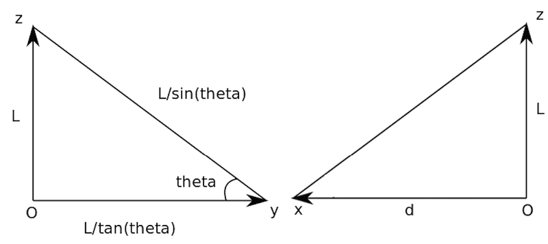

I try to find the formula of dilation of time between a reference frame (R') moving at a speed v and a fixed observer in (R). For this, I take the example that we often find as a demo : that of a train in which a light beam is emitted vertically (in the train): this vertical trajectory in the train forms, with the segment v * dt and the vertical length L that travels the light in the train, a right triangle. This is illustrated in the diagram on the left of the figure attached. This gives immediately, with Pythagore's theorem, the relation:
[tex]c^2 dt^2=c^2 d\tau^2 + v^2 dt^2[/tex]
which leads to :
[tex]d\tau^2/dt^2+v^2/c^2[/tex] and finally : [tex]d\tau=dt/\gamma[/tex]
Now, I would like to find the same formula but by placing the observer of (R) at a distance "d" from the plane (Oyz) (and with z = 0) and placed along the axis (0y) at the special place where the light reaches the bottom of the train (see the diagram on the right in the figure attached). If I take the events (in R) ##t_{reception,top}## and ##t_{reception,bottom}##, I find that for the observer, the time interval between these 2 events, taking:
1) a common synchronization for (R) and (R '), that is to say at the emission of the photon from the top, ##t=\tau=0##
2) ##t_{reception,bottom}=\dfrac{1}{v} (\dfrac{L^2}{sin^2(\theta)}-L^2)^{1/2}+\dfrac{d}{c}##
and
##t_{reception,top}=\dfrac{1}{c }(d^2+\dfrac{L^2}{sin^2(\theta )})^{1/2}##
Finally, one gets :
##\Delta t = t_{reception,bottom}-t_{reception,top}=\dfrac{1}{v }(\dfrac{L^2}{sin^2(\theta)}-L^2)^{1/2}+\dfrac{d}{c}-\dfrac{1}{c}(d^2+\dfrac{L^2}{s in^2(\theta)})^{1/2}##
By taking ##\Delta \tau = \dfrac{L}{c}##, I can't manage to find the classical relation between ##\Delta \tau=\Delta t/ \gamma##
If I take d = 0 (the observer is considered to be in the plane (Oyz) in the expression of ##\Delta t## above, I find, :
[tex]\Delta t = t_{reception,bottom}-t_{reception,top}=0[/tex] which is normal because the observer receives the photon from the top at the same time as the photon of bottom is emitted and so observer receives it instantly.
In the classical demonstration with the right triangle, how can we consider that the observer instantly sees a right triangle? , that is to say we do not take into account the distance between this triangle in the plane (0yz) and the observer (which is at a certain distance on the axis (Ox) of my diagram: in my example, I take this distance equal to "d").
Any help is welcome

I have put the following image which is more precise :
https://imgur.com/a/35dsG
The train is moving along (Oy) axis and light starts from point A to point B. (R) is the rest reference frame and (R') is the moving reference frame.
I have understood that right rectangle has sense if I want to "rebuild" the reality, by considering the distance at which events occur and the time shift between emission of photons and reception in (R) by the 2 observers in rest reference frame.
first, could I consider only 2 observers into (R) reference drame ? It seems their position don't matter, provided that we know their mutual distance in order to be able to synchonize them before the experiment, doesn't it ?
One has also to know the distance between the 2 parallels of 2 observers line and moving train line.
I try to respect the following sequence, if there are errors, don't miss to tell it.
1) Firstly, the 2 observers synchronize their clock because they know the distance between them.
2) I follow, "Left" observer receive in (R) the photon from emission at point A in (R')
With the angle under which he receives the photon and knowing the distance orthogonal to train moving line (denoted ##d## on my figure attached), he can deduce the distance ##d_{A}## at which emission occurred. Then, this emssion happened at ##t=t_{A}-\dfrac{d_{A}}{c}##.
3) "Right" observer receives the photon from point B into (R). This photon has been emitted from (R') at point B. Like above, he deduces the distance ##d_{B}## at which
events occurred and the time shift ##t=t_{B}-\dfrac{d_{B}}{c}##
4) The 2 observers "rebuild" what has precisely happened and try to analyse the results.
For this, one can write :
##\Delta t_{reconstruction}=(t_{B}-t_{A}) - \dfrac{1}{c}(d_{B}-d_{A})##
For the moment, I take ##d_{A}=0## (it will be interesting to consider the case with ##d_{A}## not null).
that gives :
##\Delta t_{reconstruction}=\Delta t_{reception} - \dfrac{L}{c}\,\,\,\,\,\,\,## with ##\Delta t_{reception}=t_{B}-t_{A}##
##\dfrac{L}{c}=\Delta t_{reception} - \Delta t_{reconstruction}=\Delta t_{reception} - \dfrac{d}{v}##
with ##d=v\Delta t_{reconstruction}## the real distance performed by train between the interval ##\Delta t_{reconstruction}##.
So Finally, I get : ##L^{2}= c^{2}\Delta t_{reception} - \dfrac{2 c^{2} \Delta t_{reception}\,d}{v}+\dfrac{c^{2}d^{2}}{v^{2}}\,\,\,\,\,\,\,\,\,\,\,\,\,\,\,\textbf{eq(1)}##
From this part, I can't get to find the expected expression of time dilation, i.e : ##L^{2}=c^{2}\Delta t_{reception}^{2}-v^{2}\Delta t_{reception}^{2}##
I suppose that ##\Delta t_{reception}## represents the ##\Delta t## into the classical and expected expression of time dilation.
Could anyone see what's wrong or help me to find, from ##\textbf{eq(1)}##, the classical relation : ##L^{2}=c^{2}\Delta t^{2}-v^{2}\Delta t^{2}## with ##\Delta t = \Delta t_{reception}## ?
Any help is welcome, thanks
@fab13 - am I right in thinking that you are describing the following experiment?
There is a train moving along the y axis. There are two observers, A and B, standing by the track. As the train passes A it emits a light pulse that A receives at time ##t_A##, after the pulse has traveled a distance ##d_A##. As the train passes B it emits a light pulse that B receives at time ##t_B##, after the pulse has traveled a distance ##d_B##. You later define ##d_A=0## and seem to start using ##L## in place of ##d_B##.
If the above is correct, nothing you have done will allow you to derive the invariant interval. The interval is the "distance" in spacetime between a pair of events. All frames will agree on it. You seem to be trying to construct a relationship between three events using measurements made in only one frame. You can't show invariance between frames without making measurements in two or more frames.
Also, note that light is not emitted from a frame. It's emitted at an event; a frame is just a choice of coordinates to describe that event. The same event is described in all frames.

@Ibix : The points A and B are the extremities of a vetical line into (R'), i.e into the moving reference frame. You can have an illustration on the following figure :
In my experiment, I only consider the first path, not the round trip, i.e I consider the path before the top reflection of mirror.
By taking my calculation, I am near to get the common relation of time dilation :
but something is wrong; currently I get from previous reply post :
##L^{2}= c^{2}\Delta t_{reception}^{2} - \dfrac{2 c^{2} \Delta t_{reception}\,d}{v}+\dfrac{c^{2}d^{2}}{v^{2}}\,\,\,\,\,\,\,\,\,\,\,\,\,\,\,\textbf{eq(1)}##
I think I have to do, between my relation and the common one, the assimilation :
into : ##L^{2}=c^{2}\Delta t_{reception}^{2}-v^{2}\Delta t_{reception}^{2}##
But I am not sure about this assimilation : it may be actually ##\Delta t =\Delta t_{reconstruction}## ?
I hope you will better understand my issue
All you need to do is eliminate L between ##\Delta t'=L/c## (from the left hand diagram) and ##L^2+v^2\Delta t^2=c^2\Delta t^2## (from the right hand diagram), surely? Or am I misunderstanding your problem?
