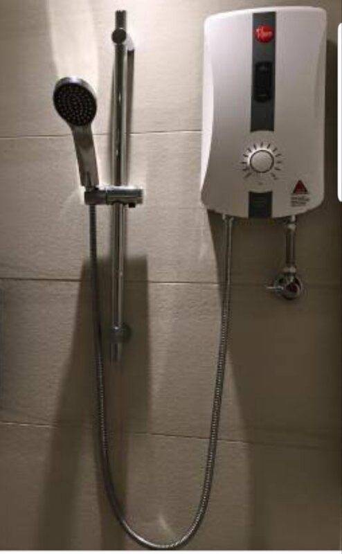

The following is what i mean. All single points heaters i saw have the shower head connected to the unit itself. Of course it has a hose and not the sprinkler head coming from unit without hose.
Wall-mounted electric instantaneous water heater with a dial control and a hand-held shower head on a vertical slide bar, connected by a flexible hose to the heater's outlet.

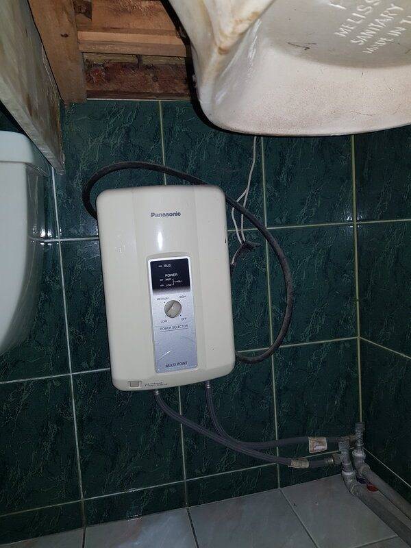

Photo of a cream-colored Panasonic multipoint electric water heater mounted on green tiled wall, with a power selector dial reading OFF, LOW, MEDIUM and HIGH, and water pipes entering from below.
In other words. I want to replace this defective multipoint with a single point since it only serves the shower. Its a used house. Former owner used wires meant for single point so ill let my electrician connect the single point to it. But I am concern what would happen if the isolation point or part where water flow is controlled after the outlet valve of the single point (see prior message). Any ideas?

look at the picture you provided in post 5 and 8 ( the one just above ha ha ) .
Here is my take of the units.
Is the following what you yourself would consider to be the case for the units?
single point.
The valve is before the heater unit, so it goes city pressure --> valve --> heater unit --> shower head.
Multi point would goes city pressure --> heater unit --> your choice of valve( s) --> your choice of outlet ( sink or shower ). Heater unit is under city pressure.

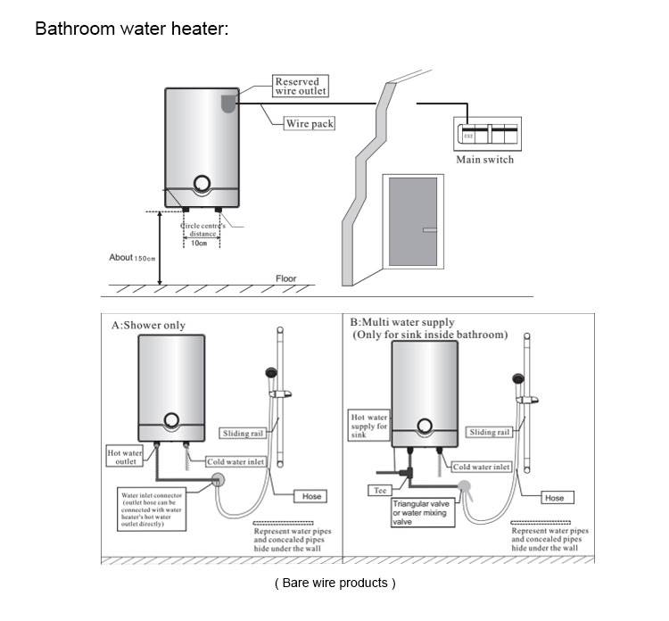

There are pressure sensors inside the multi-point heater that indicate the demand of water flow, so more heat automatically goes into the water in high demand conditions.
I believe that yours is a replacement in kind, as your old multipoint heater has always worked as a single point.
One of the pipes that are shown in your picture brings cold water into the heater, while hot water flows directly to the shower through the second pipe.
Most heaters have a built-in pressure relief valve, so any excessive pressure is automatically released to protect both the heater and the user from high pressure build up.
The outlet water temperature is controlled by a heat stabilizer in such a way that your shower gives steadily warm or hot water during pressure changes.
As previously advised, always check the installation instructions manual of your specific heater prior installation.

Yes . I know what you are getting at.
But, besides the unit itself and internal workings, the threaded connections have to withstand the pressure.
A connection to a shower hose is a lot different than a connection to the pressurized system.
If the shower hose connection leaks, it leaks into an already "wet" area with a drain.

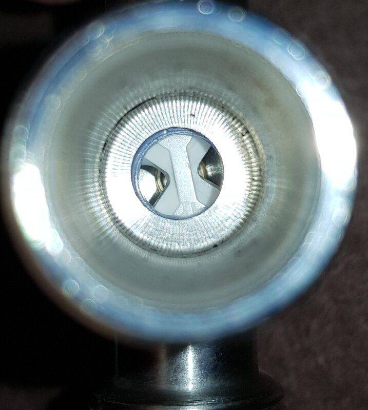

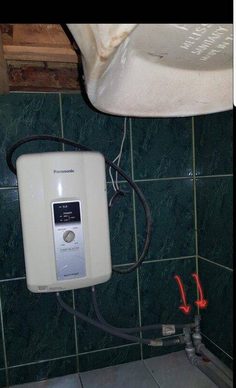

I finally uderstood what caused the great pressure loss after water passed through the multipoint heater. Output is only 25% the strenght of input. It's the damned valves shown in red.
Panasonic multipoint electric water heater mounted on green tiled wall beneath a toilet, with pipes at the lower right where two red arrows point to the valves.
The holes are very small in the inlet. This is when valved turned on.

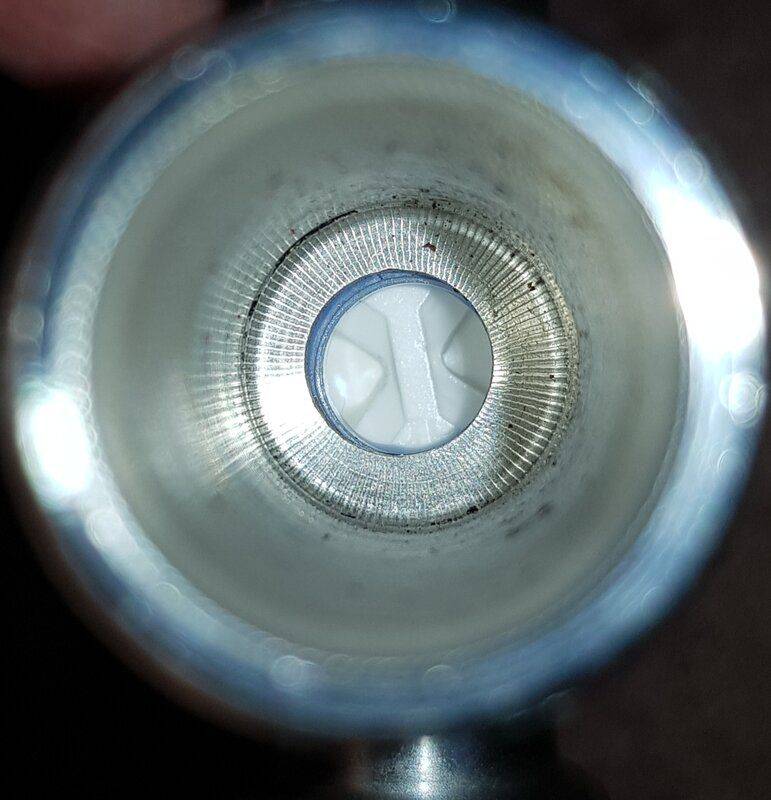

When valve turned off
Close-up photo looking down into a tubular metal fitting with a ribbed inner bore, ending in a small round opening with a white plastic valve or plug inside it.

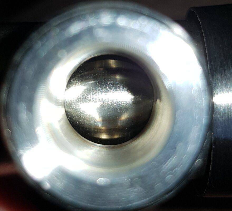

This is the outlet with a big piece permanently blockage it.
Close-up photo looking into the open end of a shiny metal tube fitting, with a dark circular bore and a smooth bevelled rim reflecting bright light.
