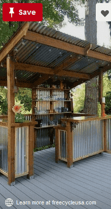

Most impressive solar pool heater i ever saw was much simpler.
The guy built a decorative structure with a shed roof to provide a shady area adjacent the pool. He put his Tiki bar, a small fridge, lights, and and some lounge chairs under it.
The roof he made from corrugated aluminum painted black
and covered that with a piece UV resistant plastic sheet made for greenhouses.
At the high end of shed roof between it and the plastic sheet he put a "header", just a piece of PVC pipe with holes drilled to distribute water into the corrugations ,
and collected the warmed water at bottom with a plain old rain gutter that drained right back into the pool. He plumbed the header into the pool pump, also with PVC.
That gave him tremendous area to collect heat with great thermal conduction right into the water. The plastic sheet prevents evaporation and keeps out the bird droppings.
And he got a nice looking conversation starter not an ugly coil of pipe.
Just a thought, one that seems to make sense from a heat transfer point of view.old jim

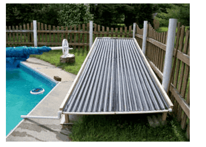

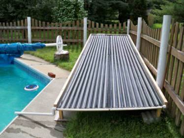

Here's a similar collector sans cover and Tiki bar
http://www.builditsolar.com/Projects/PoolHeating/OpenFlow/OpenFlowCollector.htm
half as long twice as wide and six feet taller would make it aesthetic and dual purpose.
