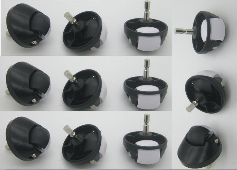

You may want to push the castor idea again.
A segway is not much good for racing, if you apply to much torque the whole thing tips over so acceleration is limited.
Check out how a roomba works, they have two wheel drive like a segway but also have a small castor wheel so tipping isn't an issue:
12PCS-LOT-Caster-Assembly-font-b-Replacement-b-font-Front-font-b-Castor-b-font-Wheel.jpg
Notice how the wheel is coloured, it's so an encoder senses it's rotation- if the drive wheels are rotating but the castor isn't, the roomba knows it is stuck.
