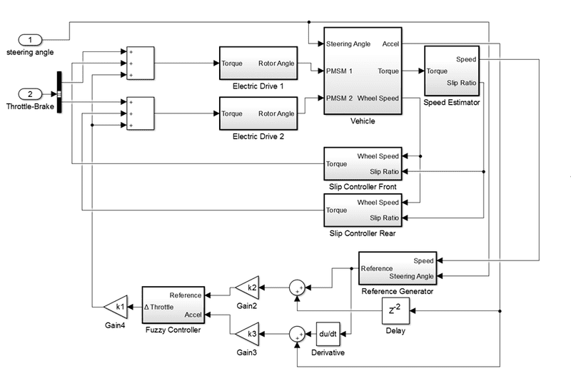

I am a beginner in terms of mechanics and am an electrical engineer so I apologize in advance for asking what may be trivial questions. I am attempting to create a prototype design for an electric vehicle (truck) in which I am mimicking the Telsa drive train configuration but I am stumped on a couple of points which I was hoping the PF community could clear up for me. The vehicle model I am considering is a dual drive electric AWD vehicle, having a front and rear trans-axle with a 65KW motor on each axle (there is no mechanical connection between the front and rear axles).
1.) In an electric vehicle how is all wheel drive typically implemented in the scenario where there is a 65 KW PMSM (w single speed transmission) on both axles? Are there any reference materials explaining the torque splitting process for this type of situation?
To the best of my understanding it would be done through a torque management system which would limit the maximum torque to the front and rear axle based on the traction available to the front and rear axles.
2.) Why can't you maintain the same torque on each axle in an AWD configuration?
I can't find a good reason for this other than it might cause excessive some stress on each axle and cause wheel slip in certain conditions, but I spoke to an automotive engineer and he told me that it is dangerous to do run both motors at the same speed.
3.) I am trying to run some numbers for a first order approximation, but I am unsure of how to incorporate torque from two motors into my calculations (would the torque just be doubled in a dual drive system) See model here?

I will be using two motor control units which comprise of a motor, inverter, and micro-controller these accept torque or speed requests (these will comprise me inner loops) for the outer loop I was hoping to keep with something which can be rapidly developed to adjust to new traction conditions. Thus I am thinking of opting to go with a fuzzy control unit for my outer controller (see attached image) which is an implementation of the techniques presented in this https://www.researchgate.net/profile/Farzad_Tahami/publication/228705412_A_Fuzzy_Logic_Direct_Yaw-Moment_Control_System_for_All-Wheel-Drive_Electric_Vehicles/links/09e4150ec0c1c46507000000.pdf .
Hesch said:
On which foundation are you driving? Same answer as the previous.
To start off with I will be using dry asphalt/pavement at 25°C and testing model functionality, Would I have to do my own FEA analysis for the road-tire interface in order to accurately model the force transfer between the tire and the road?
Cheers,
Raazi

I'm not sure if this applies but I'm trying to develop a prototype which is AWD (not sure what the difference between that and 4WD is). The reason why I was speaking about speeds is that I was referring to motor speeds (RPM) for the front and rear motor. I am trying to implement a similar strategy to Tesla by optimizing the performance of both motors by keeping them closer to the peak operating point. I am still investigating whether or not this is possible since having the motors operate at different speeds would causes (2) issues: (1) as you mentioned strain on the chassis and trans-axle components, (2) Either the front or rear wheels spinning out if the difference is large enough. The idea here is that on a flat surface it won't matter that much, but on a titled surface it can make a notable difference if the motors are spinning at optimal speed while going uphill or downhill (even a lateral tilt), and only delivering the required amount of torque in order to conserve battery. I don't know if it will make a significant improvement to the range of the vehicle but its something. Eventually project is supposed to lead into regeneration but I'm staying clear from that issue right now.

I still don't get how front wheel speed can be different from rear wheel speed, other than different tire radii or gear ratios.
From the previous source, it says: «An example of this is the dual motor variant of the Tesla Model S, which on a millisecond scale can control the power distribution electronically between its two motors.» The motor speed is no controlled, the power is. Even if the motor power is zero, it doesn't mean that the wheel speed is zero. For example, a RWD vehicle have zero power on the front wheels, but they still have the same rpm as the rear ones.
See, it's the friction force that determine the wheel rpm. The wheel angular velocity is the linear speed of the axle (i.e. the vehicle) divided by the tire radius. If there was no friction, the tire would just slide.
Now, if you increase the wheel power input, you will not change the wheel rpm - it will stay the same - but you will increase the wheel torque. By increasing the wheel torque, you MAY increase the vehicle speed and the wheel rpm with it. If the vehicle is leaning against a wall, it will just push harder on the wall, with nothing moving. If you exceed the friction limit, you will only increase the wheel rpm and the power will be lost through heat instead of vehicle acceleration.
With a typical 4WD (off-road) with a single engine, you are stuck with the mechanically "locked" drivetrain to distribute the power efficiently. Any other system will tend to send the power to the wheel with the least friction resistance - exactly the opposite of what we want - leading to one wheel spinning and all others with zero power. Note that in this case, zero power is due to a wheel speed of zero, because there is a wheel torque on each of the stopped wheels (reacting to the least resistive wheel torque that is spinning).
In your case, you have an independent power source for each axle. So you can control the power distribution at will between the 2 axles. Obviously, if you reach the friction limit of an axle, you should stop increasing the torque input for that axle. Though, you will still need to increase the power as the speed increases (i.e. while maintaining the same torque). If you reach the friction limit on both axles (even if they were at different maximum torque settings), you would need to increase the power of both motors only if the vehicle speed increases.
The best way to determine if a wheel is spinning is to compare the wheel rpm to the vehicle speed (from a GPS or an accelerometer, for example).
