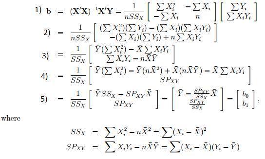

Martin V. Messages 10 Reaction score 0 Thread starter Dec 2, 2015 #1 Hello hope you can help me. Can anybody tell me what goes on from equation 3 to 4. especially how gets in? Attachments 12309069_10208024351467795_1760751714_n.jpg 24.4 KB · Views: 515
RUber Homework Helper Messages 1,687 Reaction score 344 Dec 2, 2015 #2 Note that ##\overline{Y}(n \overline{X}^2 ) = \overline{X}(n \overline{X}\overline{Y}).## This means that from 3 to 4, there was an addition of zero...likely to make the step from 4 to 5 more clear.
