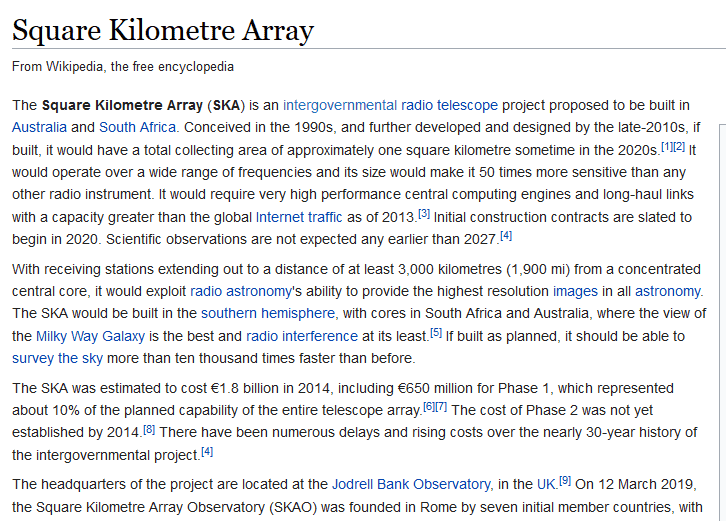

As some of you probably know, the Square Kilometre Array will become the biggest radio telescope on Earth, with a collecting area of 1 square kilometre.
The construction will start in 2021 and the first light is expected to take place in 2027. It will cover the frequencies from 50 MHz to 15 Ghz.
But what I wanted to share with you guys is a new study about how far the SKA can 'listen'.
A recent study points out that the SKA could detect extraterrestrial airport radars 200 light years away.
Source:
What do you guys think?

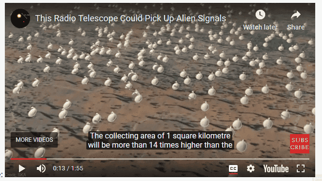

Very interesting, thanks for posting. It looked like the lower frequency dipole array uses regularly-spaced antennas, but what is up with the irregular spacing of the higher-frequency parabolic dishes? Is there a reason for the apparent random spacing shown in the simulation/rendition video?

You want all baselines and all angles covered. In principle you want a perfectly random distribution, but practicalities (like finite telescope size) preclude that. But it's close.

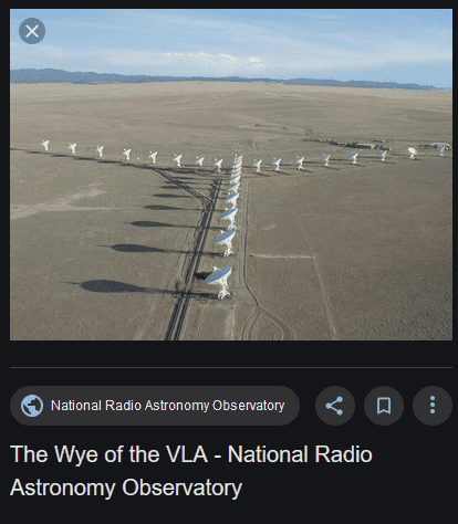

Interesting. Does the VLA use random spacings along their regular tracks? And the phased array radar systems that I'm aware of use very regular spacing to make the math easier in combining the signals.

I'm not a radio astronomer, but I believe VLA looks like it does because the distances and angles are somewhat tunable, which mitigates the problem, and it has many fewer telescopes so of you randomized it you would have a much smaller aperture. Making it the not-so-VLA.

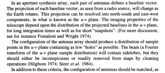

Early Radio Astronomy arrays of antennas were regular because all processing was narrow-band, analogue, on site, and in real time. Time delays between elements were programmed with coaxial delay lines and/or analogue phase shifters. By arranging an array with a N-S and/or E-W orientation it made it possible to scan the sky as the Earth rotated, or to track one point in the sky over a period of time.
The initial VLBI network employed what bigger dishes were available to get Earth dimension arrays for high resolution. The bandwidth was low as all data was digitised and recorded on magnetic tapes, one bit data, one track at the time, rewind the tape, record the next track, change tapes every few hours. Those tapes were sent airfreight to the correlator facility. Synchronising the data streams prior to correlation initially took most of the time because more accurate time references via GPS were not then available. A VLBI observation took 12 hours as the antenna locations rotated on the Earth, while each and every antenna tracked the same point in the sky. All spatial frequencies of the available antenna array would appear in the data record. That attenuated false correlation peaks while accumulating the hopefully true correlation image.
Waiting 12 hours means that half the observers will see the source rise, while the other half see it set. By using irregular arrays with low spatial self-correlation, but with a great total area, it is not necessary to wait for Earth rotation to spread the spatial array pattern to remove the artefacts of the array.

The VLA telescopes can move on rails to get the optimal position for a given observation. Putting all telescopes in three directions with railway lines looks like an efficient way to do this. I don't have maps for the resulting patterns, but I would expect that they are quite flexible.
SKA will look for very faint things with a huge number of telescopes. Moving them around would cost too much, scattering them in an irregular pattern is easier.

It's a so called Sparse Array which will give good resolution with less sensitivity than a fully populated array. The random spacing allows wide band operation because it suppresses bad sidelobes at awkward frequencies that would be susceptible with regular spacing but at the expense of slightly worse overall performance. Sidelobes are a nuisance because you need to look in several different directions to see the various peaks of reception before you can identify the highest peak which is the actual target direction.
A familiar version of a sparse array is the log periodic spaced antenna which has a good bandwidth and good directivity at the expense of gain. Ideal for TV reception but not necessarily in fringe areas. (It's not as simple as that because the TV version uses various lengths of element so the design does the 'thinking' for you).
