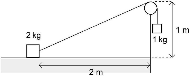

1. A mass of 2 kg is held at rest on a rough horizontal table with coefficient of friction μ = 0.5. A string is attached to the mass and is hung over a smooth pulley. A 1 kg mass is suspended from the other end of the string. The top of the pulley is at a height of 1 m above the table surface, and the 2 kg mass is initially at a horizontal distance of 2 m away from the pulley as illustrated in the diagram below.
The question is:
How far will the 2 kg mass have moved before it reaches its maximum speed?

zxfhero said:
The question is:
Thanks all above
When the 2kg mass reaches its maximum speed, its acceleration should be zero.
If the 2kg mass's acceleration is zero, the net force acting on it should be zero.
The easiest approach to this problem, is therefore to ignore the initial conditions, and simply solve for the location, x, where the net force acting on the 2kg mass is zero.
Thanks above, calculate the result. Movement of 1.4 m.
