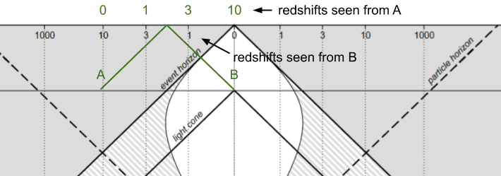

I'd like to pose a related question of interest, that further demonstrates the (to me) sometimes counterintuitive features of accelerated expansion.
Are there two galaxies such that if each sends a light signal towards the other at the same standard cosmological time, that the light signals will never meet? The answer is yes, and the challenge is, using concepts already explained in this thread, it should be straightforward to describe what galaxy we can see now would have this property with respect to a light signal we emit now.
Note how bizarre this is: we can see some galaxy now (of course, as it was long, long ago). We emit light towards it, it does the same 'now' (standard cosmological definition of now), yet the two signals will never meet even in the infinite future of the universe.
Per the well known Davis and Lineweaver paper's data, a galaxy with redshift greater than about 3.6 would have this property relative to us.

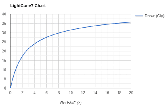

I am confused about this. Let me use an example to illustrate it:
GN-z11 is a galaxy observed at z = 11.09 (greater than 3.6). Its current proper distance to Earth is 32.2 Gly. Let’s name a galaxy half way from Earth to GN-z11 ’O’. The current proper distance from O to Earth or to GN-z11 is 16.1 Gly. Since this proper distance is smaller than the event horizon at O (16.5 Gly), it seems lights emitted by GN-z11 and Earth now will meet at O.
While in that quoted bit @PAllen is simply stating that the particle horizon at the current epoch is significantly further out than the event horizon, I think the z=3.6 is a mistake (and well spotted). Twice the comoving distance does not mean twice the redshift. This is best seen on the conformal diagram from the referenced paper:
The signals from galaxies A and B eventually meet at the half way point, which they both currently see as having z=1.8. But both galaxies see each other as being at z>10.
We can expect that lights sent now from Earth and a nearby galaxy will meet. This is also true for the case of GN-z11, which is 32.2 Gly away, as discussed in Post #15. However, we may want to know the boundary beyond which the corresponding lights will never meet. The following figure, obtained from the calculator developed by @Jorrie, shows the relation between the distance to the galaxy and its observed redshift:
As can be seen from the figure if a galaxy has a redshift greater than z = 12.5, its current proper distance is greater than 33.0 Gly. Based on the argument given in Post #13, lights emitted by it and Earth now will never meet (according the ΛCDM model).

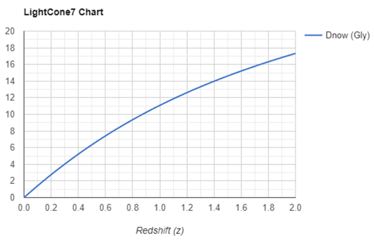

The quantity z = 1.8 is mentioned here and z = 1.8 * 2 = 3.6 in Post #12 by @PAllen. I assume these numbers are related to the writing in Section 2 of the paper by Davis and Lineweaver:
. . . in the ΛCDM model of Fig. 1, galaxies with redshift z ∼ 1.8 are currently crossing our event horizon. These are the most distant objects from which we will ever be able to receive information about the present day.​
Please allow me to add a graphic explanation of this. The following figure, obtained from the calculator developed by @Jorrie, shows the relation between the current distance to a galaxy and its observed redshift:
As can be seen from the figure if a galaxy has a redshift greater than z = 1.84, its current proper distance is greater than the event horizon, 16.5 Gly. Based on the discussions in this thread, light emitted by it from now on will never reach our location (according the ΛCDM model).
Note that the situation discussed above is similar to but different from that discussed in Post #17. There we are talking about whether lights emitted by a galaxy and Earth now will ever meet.
The newly observed galaxy HD1 has a redshift z = 13.27. See Scientists Have Spotted the Farthest Galaxy Ever and HD1 (galaxy). This means lights emitted by HD1 and the Earth now will never meet.
