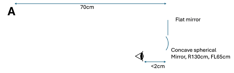

Hi,
I am working on a project for a near-eye display where I need to magnify and project far out a real image using a mirror. I have some off the shelves mirror that I am experimenting with but I can't seem to get any perceived magnification at all when I use a concave mirror. To illustrate the problem I created the following setup shown below. I have two mirrors side by side, one flat and one spherical mirror with radius of curvature of 130cm and focal length of 65cm.

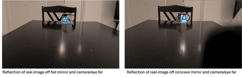

I use a phone to display a real image of the letter "A". The phone is placed at a distance of approximately 70cm away from the mirrors. Using another phone I took a photo of the reflected image on both mirrors.
As you can see from the images above the virtual image reflected off the concave is clearly a lot bigger, 2-3 times.

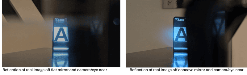

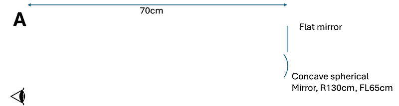

Next, I took another photo but this time I moved the camera very close to the mirrors, about 2cm, to simulate a near-eye situation as shown in the illustration below.
Please note that the I didn't move the object, the distance between the real image "A" and the mirrors is the same as before, approximately 70cm. In the photo comparison below you can see the perceived virtual image doesn't appear to be magnified at all by the concave mirror.
I have the following questions:
1. Why does the concave mirror fail to magnify the image when the eye is very close to the mirror? I thought the magnification depends only on the distance between the object and the mirror and the focal length. How does the distance between the eye of the observer and the mirror affect the magnification?
2. How can I actually magnify the image when the mirror is close to the eye? Do I have to use a different mirror, like an aspheric?
3. Since the distance between the object the and the mirror is greater than the focal length why does a virtual image still forms? I thought only real images form in that situation.
I believe the crux of your issue is a misunderstanding of your system here. The diagrams on the page that Sophie linked to, and the ones you've likely seen, are for simple systems with single a optical component (a single mirror) focusing light down onto a surface. You do not have just a single mirror. You have a mirror and then the optical system that is your camera. The simple rules shown in the diagrams get thrown out the window once you introduce additional optical components. In general, the image might end up smaller, larger, inverted, distorted, or something else depending on what exact setup you have after the mirror.
One way to model this would be to turn the mirror into a positive lens, add another positive lens after the first to represent your camera's optical assembly, and then add the camera sensor shortly after that as a surface that the image is focused onto. There might be a simpler way to go about things than this, but it's been years since I took my optical engineering classes and I can't remember.
You're also putting the camera very close to the mirror, where it intercepts the light well before it can come to focus to form a real image in the air and well before it has even converged much. I think this is the reason you're getting very little magnification. My guess is that you need a stronger mirror if you want to place the camera at such a short distance from the mirror.
