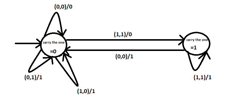

According to some notes of computability theory:
Addition of binary numbers
$$10011\\ +11111 \\ ------ \\ 110010$$
I haven't understood how they do the addition, since it holds that $1+1=0$... (Sweating)
Could you explain it to me?

How can we prove that the dfa of my initial post indeed represents the addition in the binary system?
How does binary addition work? (Wondering)
Once we know how it works, we can see what kind of dfa covers it. (Thinking)
As you said in post 4. http://mathhelpboards.com/discrete-mathematics-set-theory-logic-15/addition-binary-numbers-19097.html#post87326
We have to take into consideration that $1+1=10$, we start from the right and if we have 1+1 we write 0 and have to remember a 1.
In general, given a language and having drawn a dfa that recognizes it, how can we formally prove that the dfa is the right one? (Thinking)

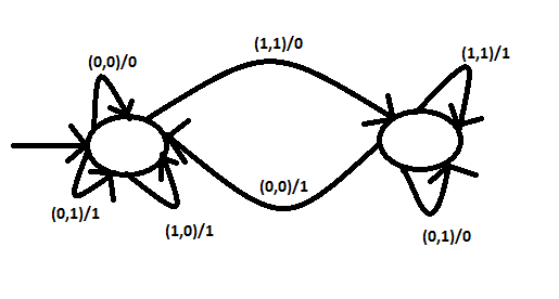

Also I think that a transition is missed at the automaton of my initial post, namely the [m](0,1)/0[/m] at the second state. I think it should be as follows.View attachment 6123
Like that we just don't get the first number of the result of the addition. But this cannot be done by the automaton since the number of the input symbols must be equal to the number of the output symbols. Right?
You're right and I think (1,0)/0 is missing in the second state as well. (Thinking)

Yes, that's true. (Nod)In order to show that the definition makes correctly the addition of binary numbers, couldn't we also use induction on the length of the binary numbers?
I have thought that we could prove that the dfa is the right one using induction on the length of the given binary numbers.
Suppose that we symbolize with $n$ the length of the given binary numbers.Base case: Let $n=1$. Then we could have the input $(0,0), (0,1), (1,0), (1,1) $.
If the input is $(0,0)$ then the machine prints $0$ which is right, since $0+0=0$.
If the input is $(0,1)$ or $(1,0)$ then the machine prints $1$ which is right since $0+1=1+0=1$.
If the input is $(1,1)$ then the machine prints $0$, which is again right since $1+1=0$ with $1$ to carry over.Induction hypothesis: We suppose that the automaton makes correctly the addition of two binary numbers of length $n$.Induction step: We want to show that the automaton makes correctly the addition of two binary numbers of length $n+1$.
If we have two numbers of length $n+1$, we first add the last $n$ digits.
So we have from the induction hypothesis that the the result of the addition of the last $n$ digits will be right. So from each number, will one digit remain.
If after the addition of the last $n$ digits we are at the first state, it follows from the base case that the result of the addition of the remaining digits will be right.
If after the addition of the last $n$ digits we are at the second state, then we have to remember that we have carried over a 1.
The possible pairs of the remaining digits are these: $(0,0), (1,0), (0,1), (1,1)$.
Suppose that we have $(0,0)$. The machine will print $1$. This is right, since 0+0+carry over =1.
If we have (1,0) or (0,1), then the machine prints $0$, which is again right since 1+0+carry over =0+1+carry over=0+carry over.
If we have (1,1) then the machine prints 1, which is right since 1+1+carry over=1+carry over.
Is it right? Could I improve something?

It looks right to me. (Happy)
There's one thing left - the numbers do not have to have the same length.
We need that if one number is shorter, it is filled out with zeroes on the left.
And then the dfa will stop when both numbers have fully been processed, which we need as well. (Thinking)
