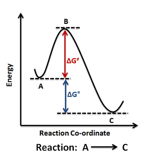

Quantum mechanics is definitely not necessary to understand combustion. The basic thing to know is that combustible molecules have an energy profile of the type
Starting at A, a molecule is stable, until it gains enough energy to reach point B, after which it can continue on to C, with the energy difference between A and C ending up as electronic, ro-vibrational, or kinetic energy. That extra energy, mostly through collisions, will push another molecule from A to C, and so on.

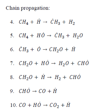

Looking deeper into it, combustion is complex because that simple picture must be replicated over many chemical species. Take for example the combustion of methane, CH4. In the simple case, A in the diagram would be CH4 + O2, with C being CO2 + H2O, with the balanced reaction being
CH4 + 2 O2 → CO2 + 2 H2O
In reality, the reaction has the intermediaries
page10image1159816288
page10image1159816592
page10image1159816896
All hot intermediaries can relax by emission of radiation, mostly in the visible and the infra-red.
