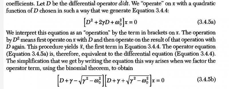

The below image shows a portion of my current Analytical Mechanics textbook.
My inquiry is how is the binomial theorem used to get from eq. 3.4.5a ⇒ 3.4.5b ?
Thanks in advance

In fact, that's simply the factorisation of a quadratic equation. You have to be careful as Operators don't always commute, but in this case, as ##\gamma## and ##\omega_0## are constants, you get the same factorisation as if ##D## were a number.
(I'm not sure I would call that the Binomial theorem. The Binomial Theorem does not apply for Operators, as they do not generally commute. I would call it the distributive law: which does apply for Operators as well as numbers.)
As an exercise, you might like to compare:
##(x + y)(x - y)## (for numbers)
and
##(X + Y)(X - Y)## (for operators).

Thank you
This clarified things
