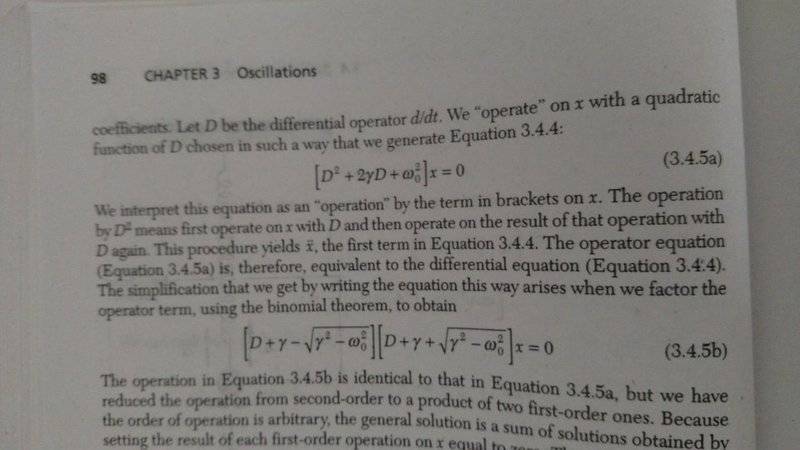

I uploaded a picture of what I am stuck on. I understand the equation of motion 3.4.5a for a damped oscillator but I don't understand how to use binomial theorem to get the expanded equation 3.4.5b. I am no where near clever enough to figure this one out. I know how to use binomial theorem to expand something with two terms but the fact that this has three terms and is only to the first power throws me off and I don't know how to apply the binomial theorem. If anyone could give me any hints, I would very much appreciate it.

The factoring has nothing to do with the binomial theorem. All that it is used is: [itex](a^2-b^2)=(a+b)(a-b)[/itex].

thanks for your response. I think it is obvious that it is a2-b2=(a+b)(a-b) going from the second equation(3.4.5b) to the first equation(3.3.5a) but I don't see how it is ovbious going from equation(3.3.5a) to equation(3.4.5b).

[itex]D^2+2\gamma D+\omega_0^2 = D^2+2\gamma D+\gamma^2+\omega_0^2-\gamma^2 = (D+\gamma )^2-(\gamma^2-\omega_0^2)[/itex]

Oh wow, ok, I see now. You are too smart. Thanks soo much! I Wouldn't have figured that one out!
