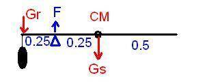

A 1.0 kg rock is suspended by a massless string from one end of a 1.0 m long measuring stick. What is the mass of the measuring stick if it is balanced by a support at the 0.25 m mark?
Torque=(distance perpendicular to force from the center of mass)(mass of force)(acceleration of force)
Torquesum=0 in static equilibrium
Torquesum=0= +(counterclockwise)(.25meters)(9.81m/s^2)(1kg) + (counterclockwise)(?.5meters?)(.25total mass Stick)(9.81m/s^2) - (clockwise)(?.5meters?)(.75TMS)(9.81m/s^2)
solve for TMS and 2.4525=2.4525TMS; TMS=1kg
So, why is ?.5meters? considered to be how far away the meter stick is from the center of mass?
Originally, the individual centers of masses I tried to put as .25meters for the left part of the stick and .75meters for the right part of the stick. How did I make a mistake?

The centre of mass of the measuring stick is at the middle. The weight of the stick acts at that point. I do not understand why do you cut the stick into two.
The torque can be calculated with respect to any point, but it easiest to calculate it with respect to the support.

oh thank you. then the center of mass with respect to the stick itself is .5meters which is why you use that quantity to calculate torque right?
Yes, the centre of mass of the stick is 0.5 m from one end. If you calculate the torque with respect to the support, you have to use 0.25 m.
ehild
thats only for the rock though right?
What do you mean?
There are three forces: the tension of the string the rock is connected to, but it is equal to the force of gravity on the rock;
the weight of stick at the CM of the stick;
and the upward force of the support.
Both the resultant of these three forces and the resultant of their torques is zero.
You can calculate the torque with respect to any point.

I do not understand you. You can take that the whole mass of the stick is at the CM, the weight acts there.
If you cut the stick to pieces, the weight of each piece acts at the centre of that piece.
How do you calculate the torque of a force?

The force has neither acceleration nor mass. The force is just force.
Supposing a massless rod can move horizontally around a vertical axis, and a force F acts perpendicularly on the rod at d distance from the axis, what is the magnitude of the torque?

I would not use 0.5 m, but the distance from the pivot point to the line of force. Have you seen my drawing? How far is the line of gravity of the rock from the pivot? What is the torque of the weight of the rock with respect to the pivot?
What is the force exerted by gravity on the stick? Where does it act? How far is that "point of attack" from the pivot? What is the torque of the weight of the stick with respect to the pivot?

Well, the torque from the rock is 1 kg * g* 0.25 m counter-clockwise,
The weight of the stick acts at the CM, middle of the stick, at 0.25 m distance from the pivot. Its torgue is clockwise,
m *g *0.25. mg*0.25=g*0.25, m=1 kg.
The equation you wrote up for the torque is wrong, but accidentally has lead the same result for m.
