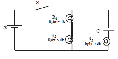

I attached a picture of the RC circuit. The question asks to find the current as a function of time for light bulb 3 (R3). I know that I=Ioet/RC where Io is the initial current that runs through R3 but what about the R in the time constant RC? Is this resistance the total resistance of the circuit or is it just the resistance in R3?

Do R1 and R2 have any effect on the current through C?
Hmmm no, I think I kind of get it now, so the capacitor only affects anything on the outer loop. So the resistance I would use is just R3 right?
(PS I forgot to mention the the switch is closed)
Now let's say instead of a switch we had an extra resistor R4. Would that mean the R in t=RC would be R3+R4 since the capacitor is affected by both resistors that are in series?
