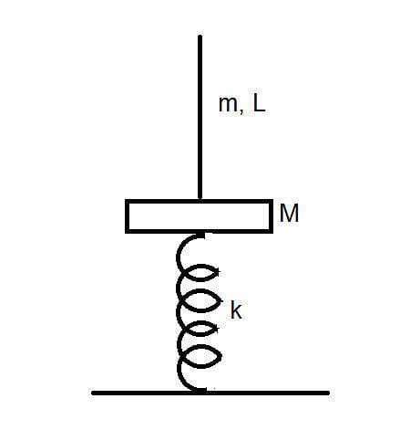

The uniform rod mass m, length L falling into mass M. M is attacked with string k. Find the velocity u of system when the top of rod falling into M.
I find this equation, but it seems wrong:
Chose origin at equilibrium position.
The rod has been divided into small segments, each of length has ##dm=\frac{m}{L}dy##
At the time t, the mass M is effected of force F, with F is:
+ The total force of gravitation and the elastic force ##F_1=ky##(magnitude)
+ The change of momentum of dm. It equals ##F_2=\dfrac{dp'}{dt}=v\dfrac{dm}{dt}=v\dfrac{m}{L}\dfrac{dy}{dt}=v^2\dfrac{m}{L}## with v is the velocity when dm touches M
So ##F=-F_1+F_2=-ky+v^2\dfrac{m}{L}##
That force equals momentum changes with respect to time of system (M+dm)
$$ F=\frac{dp}{dt}$$
$$\Leftrightarrow -ky+v^2\frac{m}{L}=u\frac{dm}{dt}+(M+dm)\frac{du}{dt}=u\frac{dm}{dt}+M\frac{du}{dt}$$
Where are wrong ? I don't have solution.
v is the velocity when dm touches M. Each of collision, String changes so I can't find v.
This way seems difficult
This last sentence makes no sense to me. I understand that your system is the mass-spring system. Do you want to find the velocity just after the rod hits the mass M?
This system is mass- rod. the velocity u at the time after the total length of the rod fall into mass M
I do not understand the set-up.
What do you mean by the rod "falling into" M? Does it penetrate it? Does it fall over? If the rod remains vertical then what is the significance of its being a rod, not a point mass?
You write that M is attached (I assume you mean attached, not attacked) with 'string' k, but you show a spring under it, not a string.
Another question:
If the rod is falling (tipping if it's initially in contact with M), is there friction between the rod and mass M? Does the point of contact slide along the surface of mass M?
I can imagine a scenario where the mass rises as it rotates the rod and increases its angular rotation rate.
Looking at the attempt at a solution in the OP, maybe "rod" should be "chain".

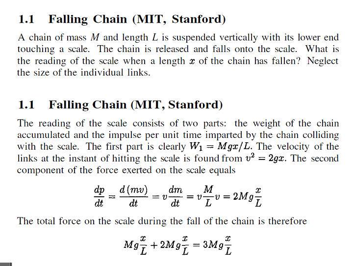

Sorry about my words mistake, it is a rope :(( All collisions are inelastic collisions. I think we need use some approximations. If we seems m<<M
+ Firstly, pretermit the change coordinates of M so we can use ##v=\frac{1}{2}gt^2## of dm
+ Secondly, pretermit elastic force because the change coordinates very small.
That is the way of my thinking. Maybe it 's wrong
Thanks for all helping.

Use this approximate I make solution:
Firstly, we find the force when ##dm_i## impact M, this force include:
+ The gravity of falled part.
+ The chage of momentum of dm
So we have:
$$F_i=F_1+F_2=\frac{m}{L}yg+v\frac{dm}{dt}=\frac{3m}{L}yg=\frac{3m}{2L}g^2t^2$$
The acceleration at time t:
$$a=\frac{F_i}{M+\dfrac{m}Ly}=\frac{\dfrac{3m}{2L}g^2t^2}{M+\dfrac{m}{2L}gt^2}=\frac{du}{dt}$$
$$\Leftrightarrow \frac{u}{g}= \int^{\sqrt{\dfrac{2L}{g}}}_0 \frac{3t^2}{\dfrac{2ML}{mg}+t^2}dt$$
Let ##a=\sqrt{\dfrac{2ML}{mg}}##
$$\Leftrightarrow \frac{u}{g} =3\int^{\sqrt{\dfrac{2L}{g}}}_0 dt-3a^2\int^{\sqrt{\dfrac{2L}{g}}}_0 \frac{dt}{a^2+t^2}$$
$$ \Leftrightarrow \frac{u}{g} =3\sqrt{\dfrac{2L}{g}}-3a\arctan{\frac{t}{a}}$$
$$\Leftrightarrow \frac{u}{g}=3\sqrt{\dfrac{2L}{g}}-3\sqrt{\dfrac{2ML}{mg}}\arctan{\sqrt{\frac{m}{M}}}$$
Is right?

Sorry because some my variable definitions are unclear.
Use some approximations: m<<M and the falling-time's small, so I seem M doesn't move on process, just moves after the process finishes. The 3myg/L is the result I finded in book " A guild to physics problems". This is the solution:
Ok, that's different from what you posted originally.
The scale spring is assumed to be very stiff, so the vertical movement of the scale pan can be ignored.
The mass of the scale pan becomes irrelevant. M here is the mass of the chain.
