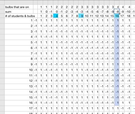

There're 60 bulbs in a classroom with 60 students. Initially all of them were switched off.Now gradually the students enter roll number wise and toggle the switches that are multiples of each of their roll numbers. For example, when roll no. 1 enters, he switches on all the bulbs(as they were all switched off initially), and when roll2 enters the room, he toggles the switches that are the multiple of 2 i.e. 2,4,6,8,10...so on.At last when the teacher entered the class how many bulbs did she find switched on??
2. The attempt at a solution
I took the roll no. of the students as i. Then he toggles the switches of the multiple of i.
I couldn't find a way to solve this equation. Can anyone help me??

See how many student toggles a certain lamp. If odd number of students, it is on. If even number, it is off. Find the numbers from 1 to 60 which have odd number of divisors. For example, 4 can be divided by 1,2 and 4. Students 1,2, and 4 will toggle it, so it will be on at the end. This is "brute force" but not that terrible.

What a delightful homework problem. It reminds me of my OCD mathematical youth, my later forages into SciAm's mathematical recreations, and a certain problem in my first year computer science class.
I know the answer, but I cannot tell you how or why, as the logic behind the square of the number increase solution eludes me.
-1 = off, 1 = on
Good luck!
ps. Is the answer in the back of the book?
pps. I will not be offended if this post is deleted, as I've implied the answer without solving the problem. :redface:
The divisors of the number of a bulb N are in pairs: if a divides it, so does N/a. There are odd number of divisors if N/a=a, that is N is a square number.
Initially, all bulbs are off. See bulb 9 for example. The first student switches it on. The second one does not toggle it, but the third student switches off. Then nothing happens till the ninth student arrives, who switches on. Find all square numbers less than 60...
