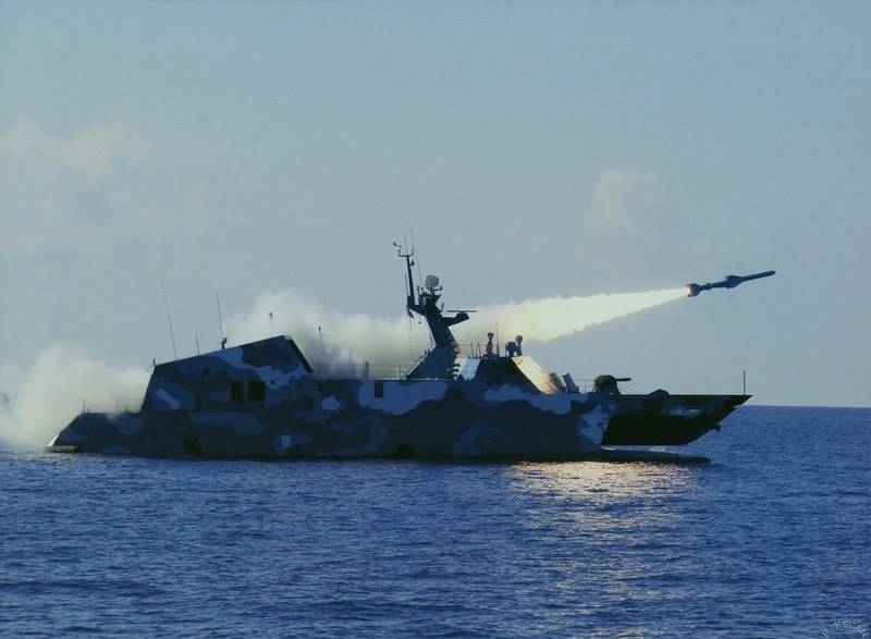

Missiles do not carry ballast. And ships that launch missiles would generally not need to do anything with their ballast when launching missiles, since the reaction forces involved in the launch are a tiny fraction of the weight of the ship.
https://s-media-cache-ak0.pinimg.com/originals/59/d9/29/59d9293c7f45df8e0c5a0951f2f8d0cb.jpg
