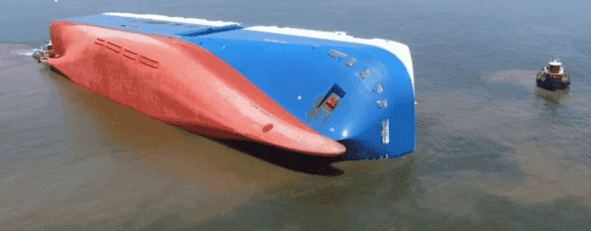

On September 8, 2019, the 200m long vehicle carrier ship Golden Ray (carrying 4067 Kia, Chevrolet, GMC, GM, Mercedes-Benz, and Ram vehicles) capsized in St. Simons Sound, Georgia, USA The accident caused the loss of a $62 million ship, $142 million in lost cargo, and $250 million in salvage costs. Fortunately, no-one was injured or killed. Only recently were the last remains of the wreckage removed from St. Simons Sound.
The NTSB report https://www.ntsb.gov/investigations/AccidentReports/Reports/MAR2103.pdf
Cause of the accident was insufficient water ballast, causing a too high center of gravity. The report says:
The chief officer made errors with the ballast tank level data entry into the shipboard stability calculation computer (LOADCOM), which led to his incorrect determination of the vessel’s stability.
The operator did not have a method in place to ensure that the chief officer was proficient in using the shipboard stability calculation computer (LOADCOM) to perform his duty of calculating the ship’s stability.
The operator’s lack of oversight and procedures for auditing and verifying the accuracy of their officers’ vessel stability calculations before departure contributed to the Golden Ray not meeting international stability standards.
My conclusion: modern technology is not a cure for operator error, nor can it ever be.

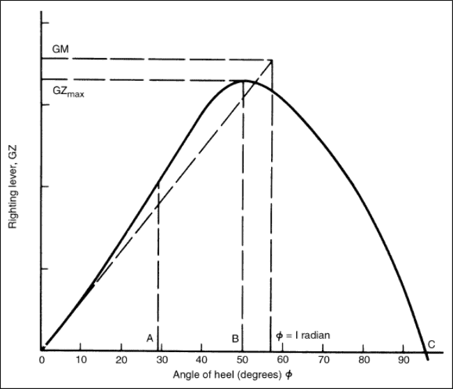

Stability is something that marine architects study a lot.
https://www.marineinsight.com/naval...bility-understanding-curves-static-stability/
Here is the righting moment, versus angle of heel (tilt).
The automated system you hypothesize might measure the righting moment in real time. It could use a model of the ship's FBD (free body diagram), compare it to real time measurements, and then estimate the critical model parameter. It would make a good postgrad project. Other automated fault detection systems use that basic strategy. GE aircraft engines report suspected engine problems back to GE by satellite.
